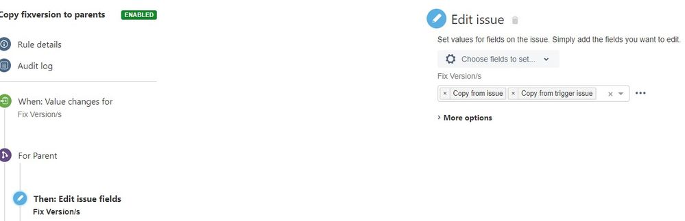

I have created a flow that copies the fixversion from a child to its parent (being that an epic or another task).
It works as a charm, but I have one problem: If I have parent P1 with children C1 and C2, if I edit C1, the automation copies C1 fixversion(s) to P1, but when I edit C2, it deletes all the values already in P1 and copies C2 ones... is there a way to prevent the deletion?
This is what I have tried so far:
Thanks in advance

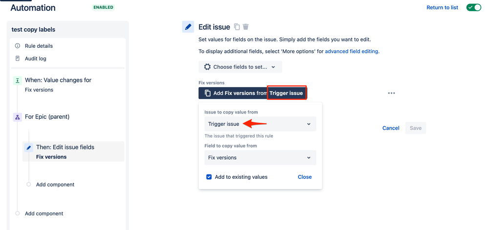

Hi @Daniele Cerfeda

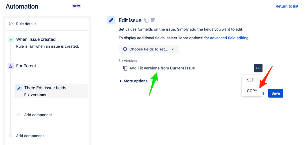

I am not sure if you're actually on cloud, because your automation interface looks different than the current one in cloud. But if you are, you should be able to change the edit type by clicking on the three dots and then "COPY" (red arrow):
After doing this, you can click on the text pointed to by the green arrow, where you should be able to select "Add to existing values". Hope this helps.

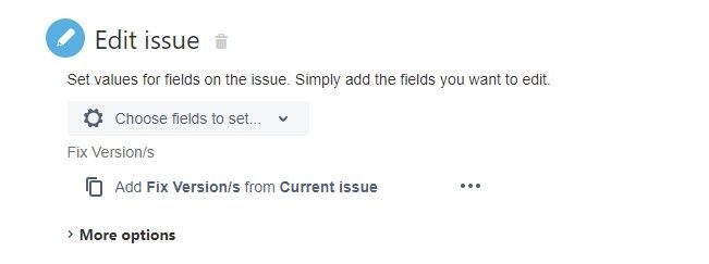

I do have something similar, but it doesn't work:
Changing from "Set value" to "Copy from", I can set it only in this way:

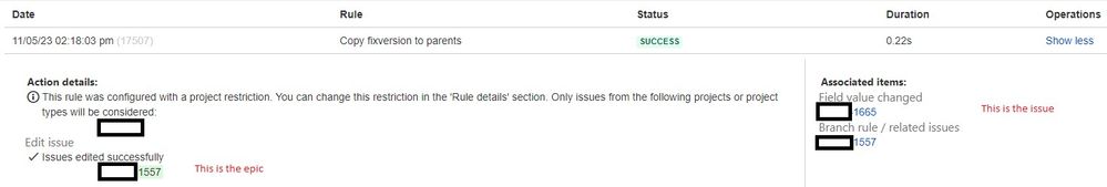

Despite the log saying it triggered and ran successfully, I can't see anything happening to the epic, that stays empty

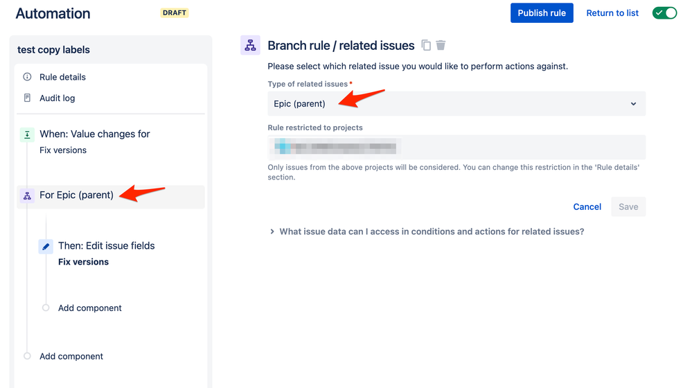

@Daniele Cerfeda Please note that there is a difference between an epic as parent and a "standard" issue as parent. The automation rule differentiates between these two types. In your case, it seems to be an epic, so you would have to change the automation rule to this:

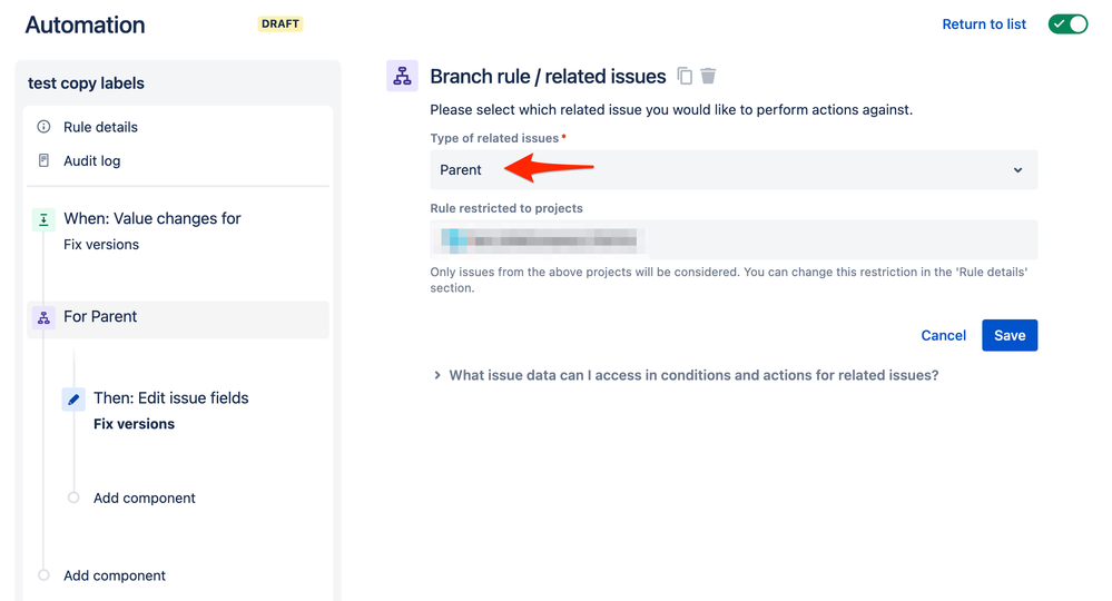

If you have a "standard" issue as parent, the automation rule looks like the one you originally posted:

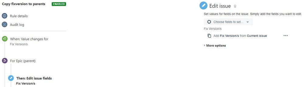

@Michel Neeser thank you for pointing that out, but I am using precisely that :)
I am not sure what I am doing wrong, or how to debug in a better way...

@Daniele Cerfeda I think setting your action to "Trigger issue" should solve the problem, as "Current issue" refers to the epic and not to the child issue:
Daniele Cerfeda May 15, 2023
@Michel Neeser I can't believe I haven't simply tried to click on the description to find that option I have been looking all around!
That works, thank you very much!
