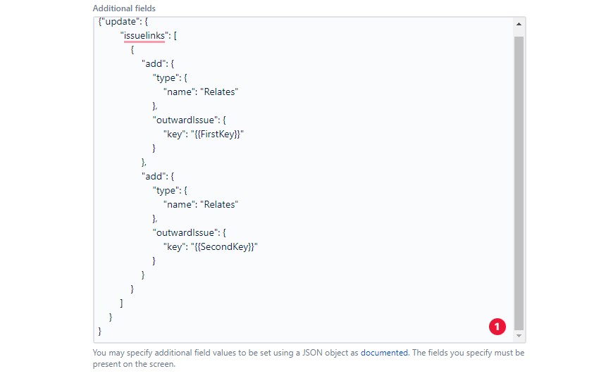

Hi Sam,
I have a manual automation that creates 7 stories.
When the 3rd one is created, it needs to be linked to the previous 2 with "is blocked by".
I tried to use the code that you suggested (used 'Create variable' for the keys of the 2 issues), but for some reason, only the last one is linked.
What am I missing?
