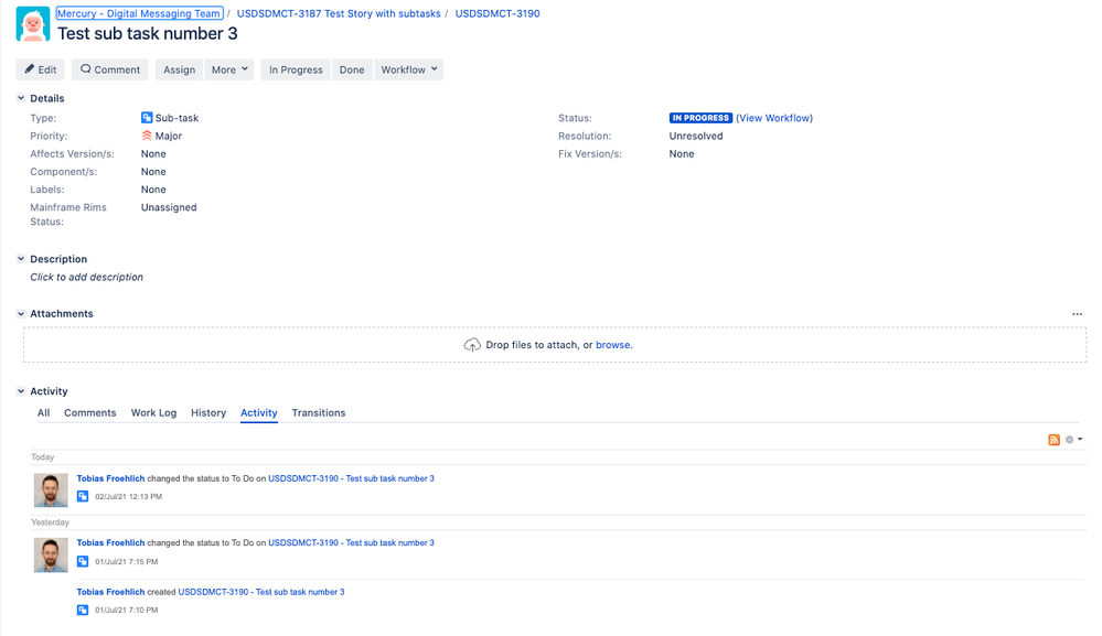

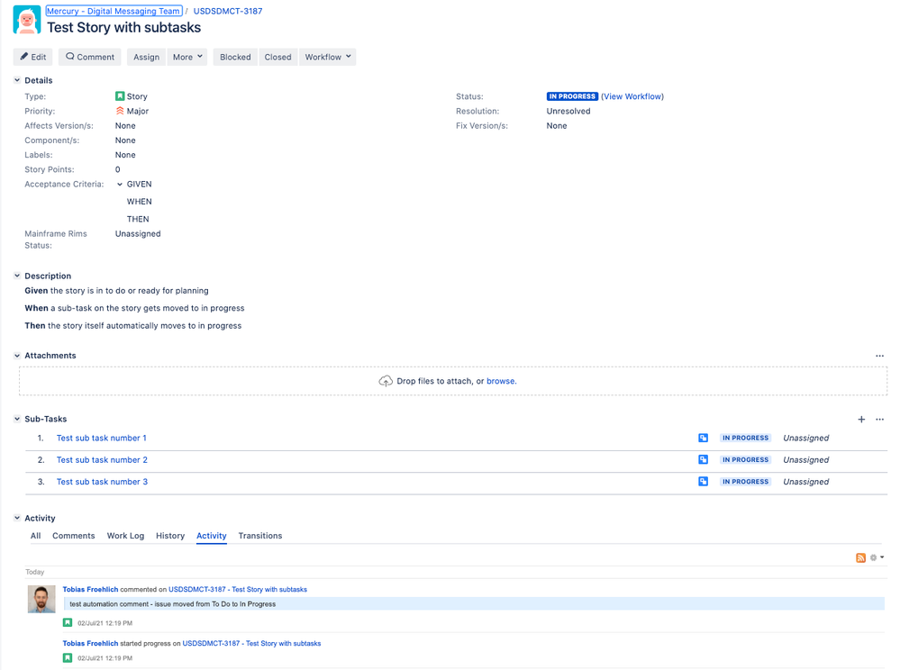

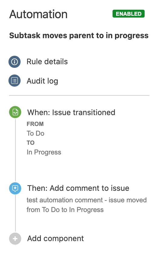

Hello! Running into a similar issue. To troubleshoot, I created an automation rule based on status transition. It triggers properly when the issue transitioned is a story, but doesn't trigger for a sub-task.
I have noticed that the sub-task doesn't have an activity entry for the In Progress transition, yet the story does (Stories and subtasks operate through different workflows in our project). What's happening here?

with that said and just taking a quick glance it what you posted (I have noticed that the sub-task doesn't have an activity entry for the In Progress transition) my guess is that your sub task workflow does not have an in progress status. If that is indeed the case then this rule will not trigger at all because you’re not transitioning to in progress. Basically if your rule isn’t triggering it all then the sub task isn’t moving from to do two in progress. Now if your role is Triggering but not executing that’s likely due to a condition or something with your action.
