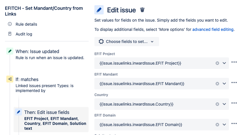

We have a use case very we need to inherit certain custom field values from the
link type is implemented by
We use the smart value   {{issue.issuelinks.inwardIssue.CUSTOM_FIELD}}
which provide the values for all inward links but I need to extract only the values for
How can this be done ?
Here is the current automation rule:

The trigger and link extraction direction is all  clear and works well with a single link.
The issue is  when we have multiple links on the same issue, then   {{issue.issuelinks.inwardIssue.CUSTOM_FIELD}} is returning the values for all links and there is no way to know which value comes from which link type
in the described scenario where we have 2 link types (blocks/Implements) we receive
Country custom field value: SK-Slovakia,CH-Switzerland
and we don't know which value belongs to which link type

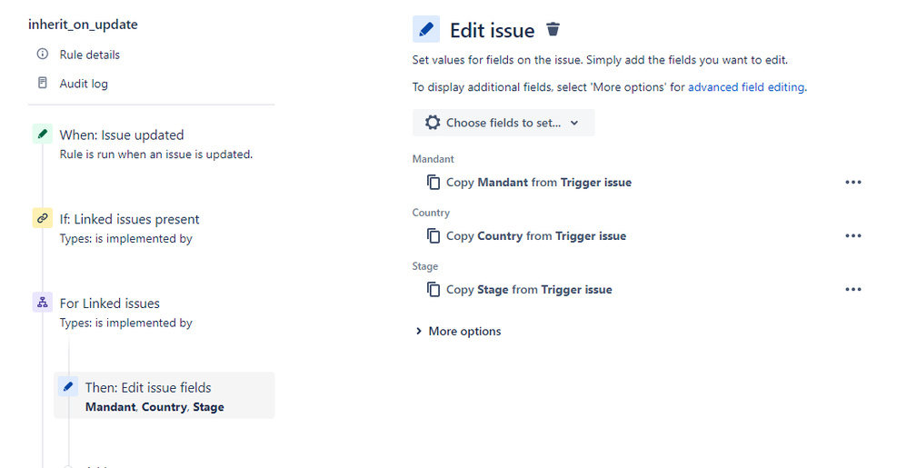

My understanding was:
  • There is an Epic A
  • Story B --> "implements" Epic A
  • Story C --> "implements" Epic A
  • Story D --> "blocks" Epic A
  • field values from Epic should be inherited to linked issues but only to those linked with "implement/implemented by"
As I got it right here please see my screenshot with the "Issue updated" trigger. I tested it on my site with having different link types in one epic and only those with the "implement" link have been updated.

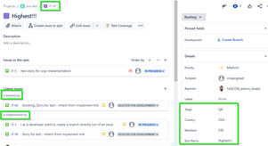

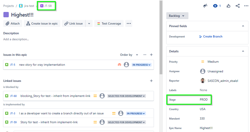

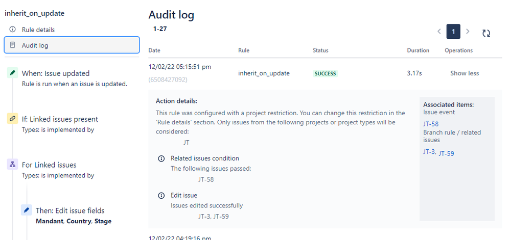

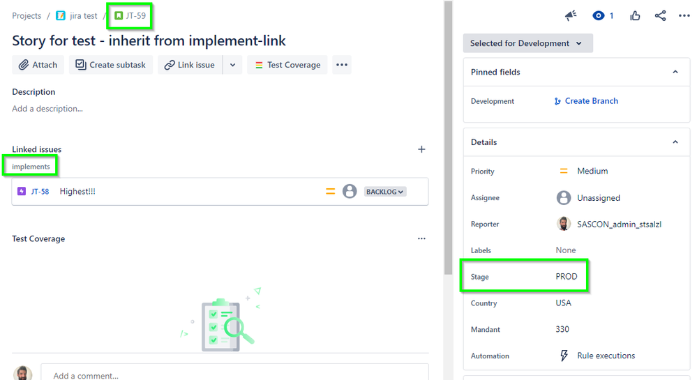

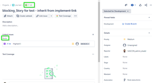

Stefan Salzl
February 12, 2022
Before change:
After changing Field "Stage" in EPIC (and automation rule):
  • no changes made in "blocks" linked issue
  • changes inherited to issues with "implements" link
  • audit log of automation rule shows changes/changed issues (the changed issues are those linked with "implement")

Stefan Salzl
February 12, 2022
Hi @Peter Reiser ,
As mentioned before I just tried to reproduce some scenarios that might fit your description/requirement:
  • "Issue update" trigger
  • "Issue linked" trigger
Looking forward to your reply.

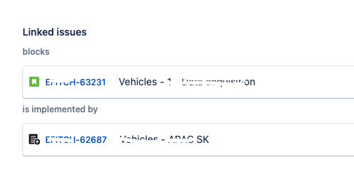

Now a story in the hierarchy  EPIC - New Feature - Story can have multiple linked issues with different link types.
As example we use Big Picture for planning where we automatically import the defined WBS structure. When we do dependency planning then link type blocks/blocked by is added.
but the hierarchy inheritance has to come from Implements / is implements by
So that means with  {{issue.issuelinks.inwardIssue.CUSTOM_FIELD}} we get all the values for all the link types:
e.g.  Country custom field value: SK-Slovakia (from link blocks), CH-Switzerland (from link is implemented by )
and we can't just pull the value for the link type is implemented by  (CH-Switzerland)
So the questions is
How can we just get the value for  Link is implemented by
