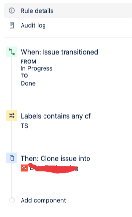

I have two automations running that trigger a ticket to be cloned and due date updated based upon a label after the ticket is moved to Done status.
Both were working flawlessly, then they both stopped working. I have scoured the audit logs to find failures after multiple test runs. It just seems to ignore it, as if the automation doesn't trigger at all.
Finally, I gave up troubleshooting and turned it off and back on again. And of course, it starts working again.
Any ideas?

Hi @Dawn Rodney
Yes, and...to the questions Stefan and Jack asked:
What type of project is this rule running against: company-managed or team-managed?
Do you have any custom transitions in your workflow for the issues? If so, there is an open defect about custom event types not triggering a rule for a transition: https://jira.atlassian.com/browse/JSWCLOUD-22466
Bill
Great call, I already experienced that issue and then found that referenced ticket and note. However, this problem is different.
I don't have any automation set up for status transitions. This is all done manually by the team members.
Dawn, I suggest a next step is to work with your site admin to submit a ticket to Atlassian support for this symptom: https://support.atlassian.com/contact/#/
They can see logs that we cannot, and they may notice something we are missing on this problem. Perhaps included a link to this thread for reference of what has been suggested thus far.
Hi @Dawn Rodney , that is most unsettling. I cannot say I have seen this. My best advice would be to open up a ticket with Atlassian support if and when the issue reoccurs. They would need to see it in that state to analyze what might be going on. What exactly is the trigger? Label field updated or issue transitioned to done?
