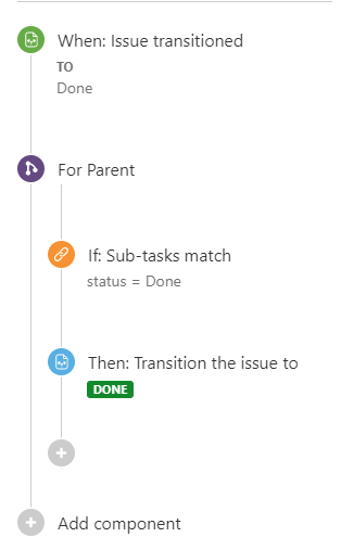

Can you try this
I create a new branch for the Parent and used the "related issue" component in the if statement
I've created the automation rule as described above. Not as a global automation rule but as project automation rule. I've created a task and several sub-tasks. I transitioned the task to "in progress" and started transitioning the sub-tasks to done.
During the execution I got thiss message in the audit log:
This rule was configured with a project restriction. You can change this restriction in the 'Rule details' section. Only issues from the following projects or project types will be considered:DEVTLS
The following issues did not match the condition:DEVTLS-1967
I continued to transition the sub-tasks to done. And although I got an error the parent task was transitioned to done. But the audit log's status was "No actions performed".
The automation rule works with some errors.
Can you fix this?
