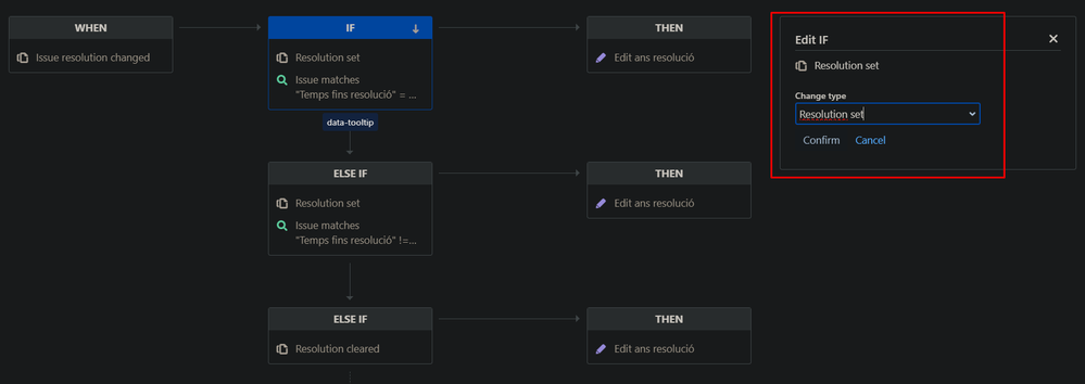

I am currently migrating a Legacy Automation rule from Jira Data Center to Jira Automation, but I am encountering difficulties due to differences in available fields and triggers.
In Legacy Automation, I used the trigger:
  • "Issue resolution changed", with a condition for "Resolution set" and "Resolution "Cleared"
However, in Jira Automation, I do not find an exact match for this condition. I understand that I can use the "Field value changed" trigger for Resolution, but I am unsure how to replicate the exact behavior, especially since some fields used in the Legacy Automation rule do not exist in Jira Automation.

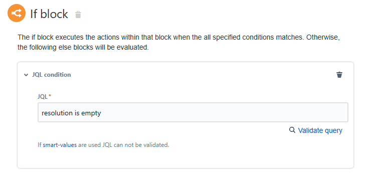

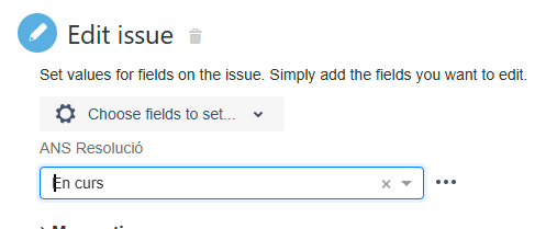

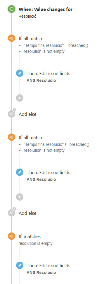

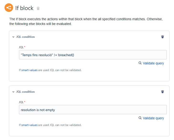

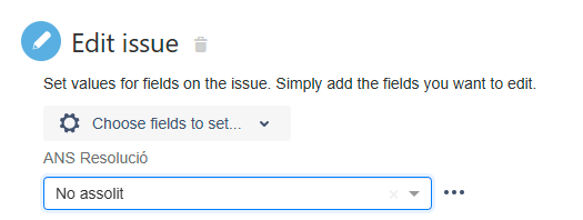

I believe I’ve finally managed to replicate the intended behavior from Legacy Automation using the new Jira Automation system. I’ve structured the rule with three separate if conditions to cover all possible resolution changes, and the results seem consistent with what I expected.
Could you please take a quick look and let me know if you also think this approach is valid?
First if:
Second if:
Third if:

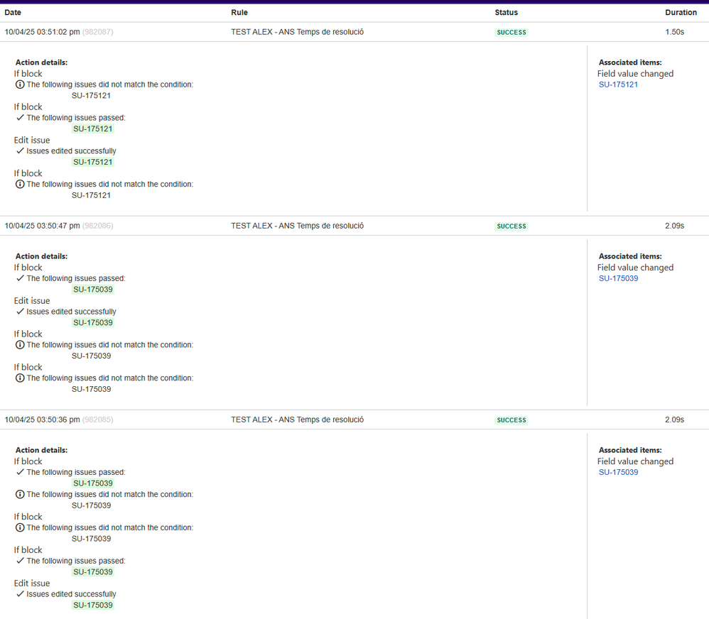

Audit Logs
I've also included screenshots of the audit logs from test executions, which confirm that each condition triggers correctly depending on the resolution change.
It looks like I’ve got the behavior I needed in all scenarios, but I’d love a confirmation from your side in case I’ve missed anything subtle.

Complete scenario:
Bill Sheboy
April 10, 2025
That looks correct.  Does your testing confirm all the cases you want to handle?
Àlex Costa April 10, 2025
Yes, I’ve tested all the scenarios, and everything is working exactly as expected now!
