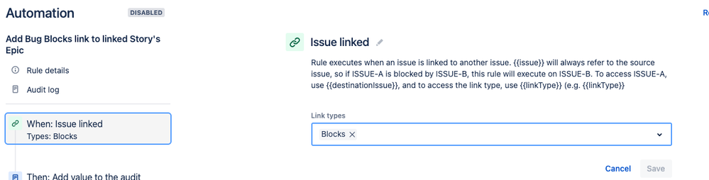

TRIGGER: WHEN an issue link is created of the Link Type "blocks"
...add other conditions to make sure you want to continue
CONDITION: the type of the issue causing the block is Bug
CONDITION: the type of the issue being blocked is Story
CONDITION: the blocked Story has a parent Epic
ACTION: Create a link of type "blocks" between the Bug and the Epic
What makes this tricky is that the Issue Linked trigger concerns two issues, and you have to understand how to reference each issue in the Conditions and Actions of the rule. The trigger gives you an explanation of this:
You will have to use the Smart Value (things in curly braces) in the Trigger description later to reference information in the Bug and Story issues that were linked.

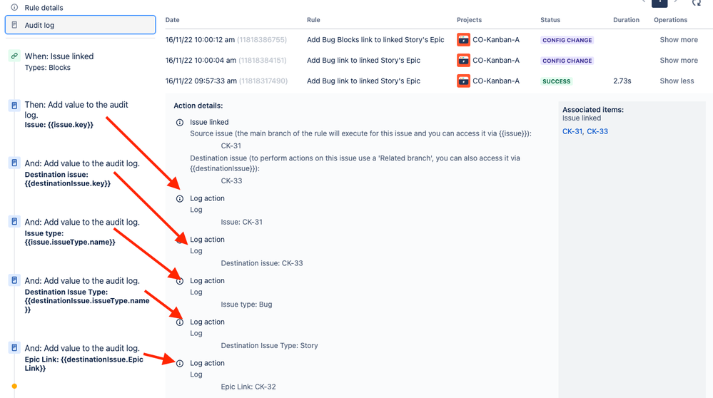

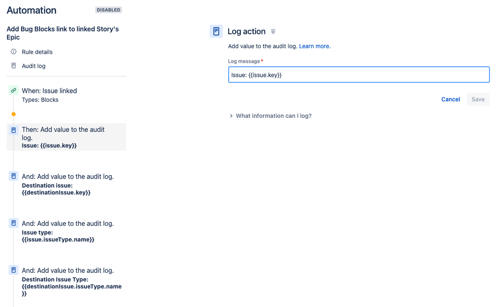

I like to use the Log action to print values to the Audit Log for the Rule so that I know what values the rule is working with.
We want to confirm that the issue causing the Block is a Bug, and the issue being Blocked is a Story. Referencing the description of the trigger, the issue causing the block can be referenced with the {{issue}} smart value, and the issue getting blocked can be referenced with the {{destinationIssue}} smart value. So, I log the values for the Issue Keys and Issue Type of each of those.

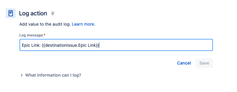

Next I log the value for the blocked issue's Epic Link field.
When the rule is run, you'll be able to see all this information in the Audit Log.

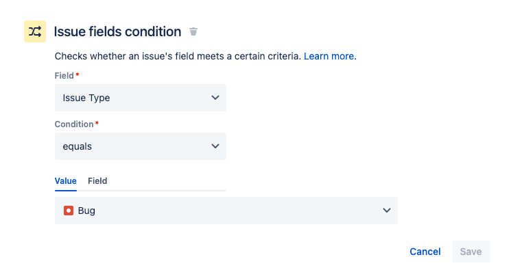

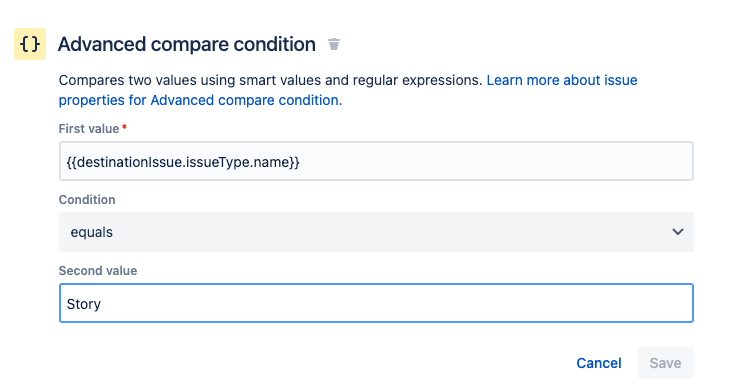

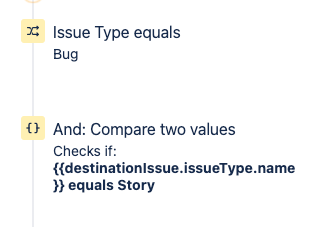

Next we add the conditions to check that the event that triggered the rule was a link created between a Bug and a Story.
Screen Shot 2022-11-16 at 11.08.42 AM.pngScreen Shot 2022-11-16 at 11.08.54 AM.png

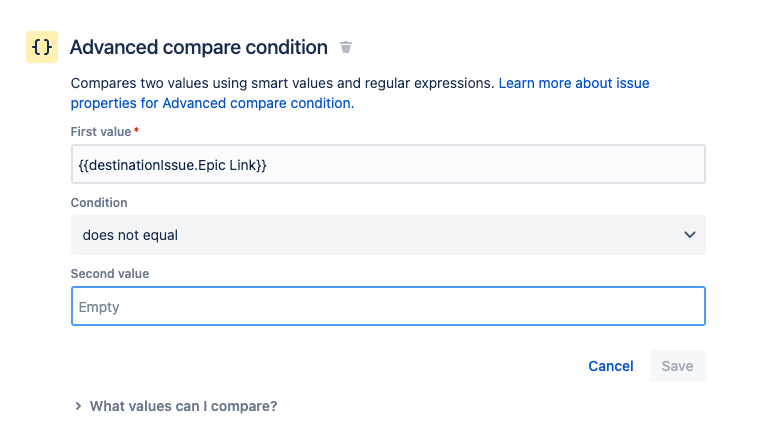

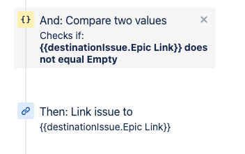

And then check that the blocked issue has a value in the Epic Link field (which is where the issue key for the parent Epic is stored).

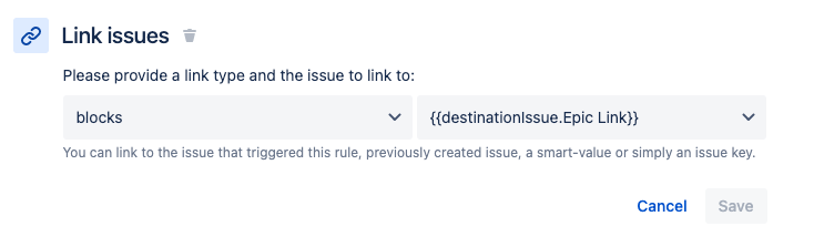

If those three conditions pass, then the next step in the rule will execute - the action to create a link between the Bug and the Story's parent Epic.

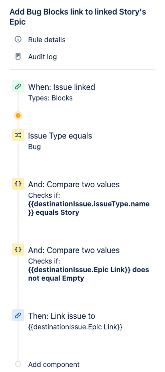

To make this a little simpler to read, here is the rule without all the Log actions.
