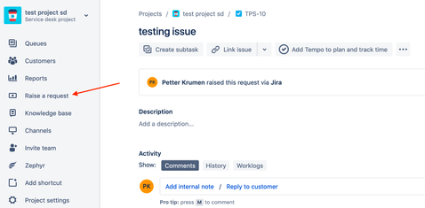

  1. Instruct your agents to create new issues using the "Raise a Request" button instead of the internal interface in your Service Desk:

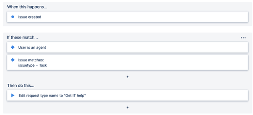

  2. Create an automation rule (Under project settings > Automation) to automatically set the related request type when the issue is created by an Agent:
    P.S: Request types are related to issue types under Project settings > Request types. That being said, you will have to use conditions to add the correct request type for each issue type the agent can select in the automation rule.
