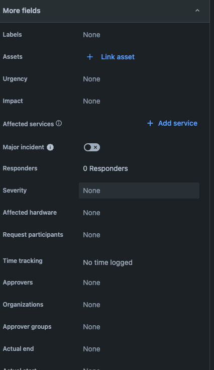

I do not have a screenshot of the issue in the source project as I have migrated all to the new project but I have a attached a screenshot of the issue in the new project.
All the jira field in the previous project were populated but it is not showing in the new project. All the issues migrated were done/resolved issues and their jira fields(linked field) were showing in the previous project but not in the new project.
I transitioned an issue back to the source project to get a screenshot of the jira fields but it did not show again even in the source project

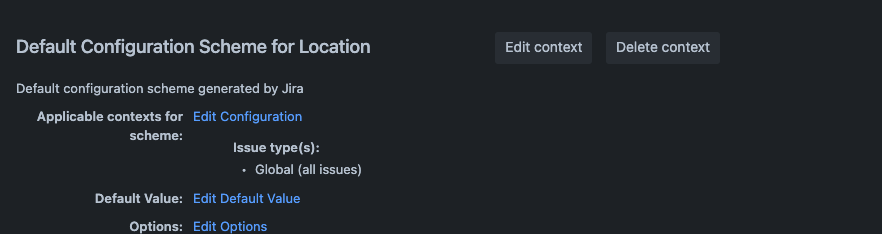

You created a Global custom field named Location. In both the source and the destination Team Managed projects you searched for this global custom field and added it rather than adding a new project-specific field.

The screen image you provided that shows "Default Configuration" is for a field named Location. I don't see a field by that name in the second screen image you provided showing data from an issue.
For whichever field is missing data you think should've been migrated, please use the steps I provided (repeated below) to get the output from an issue in the source project and the destination project, and confirm that the issues actually have the same custom field id in both projects.

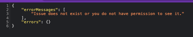

Thanks for the correction. I tried it but it says issue does not exist or I do not have permissions. I tried with another issue and the result was same.
P.S I have Jira admin rights
What is the actual URL you used?
Did you replace <yourinstanceurl> with the actual base URL for the Jira instance you are using?
Where I used myCompanyName.atlassian.net - that is just an example. You have to use the base URL for your Jira instance there.

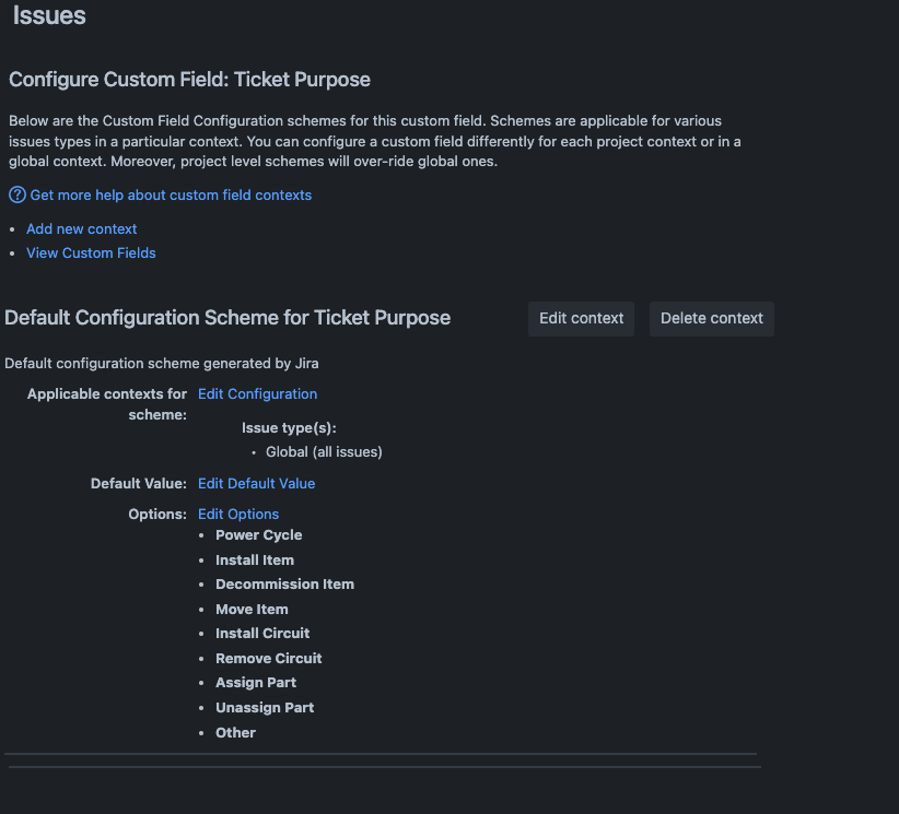

Can you show us the information from the Custom Fields screen for this field so we can see how it is configured?
Can you confirm for us that the custom field ID you see in the JSON output for that field matches the custom field ID associated with the globally defined field? If you select the Edit option for the field in the Custom Fields list the URL will include the ID for the field:
secure/admin/EditCustomField!default.jspa?id=10009
You have said that the source and destination projects are both team managed. Are they Software or Service Management projects? The screen image that you provided that shows multiple fields with None for the value includes fields that are typically used in Service Management projects.
I have included a screenshot of the JSON output , custom field screen for the field - ticket purpose. the custom ID values are the same
They source and destination projects are team-managed service management projects

Those screen images appear to confirm that you are working with a globally defined field, at least for Ticket Purpose, in the Team Managed projects.
