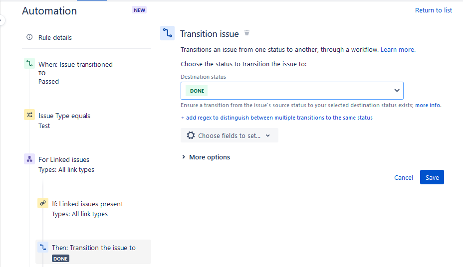

Yes this is definitely possible, please follow the below steps to set and configure your Automation Rule.

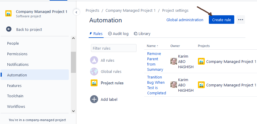

  1. From Project Settings, go to Automation and create a new rule from the top right button

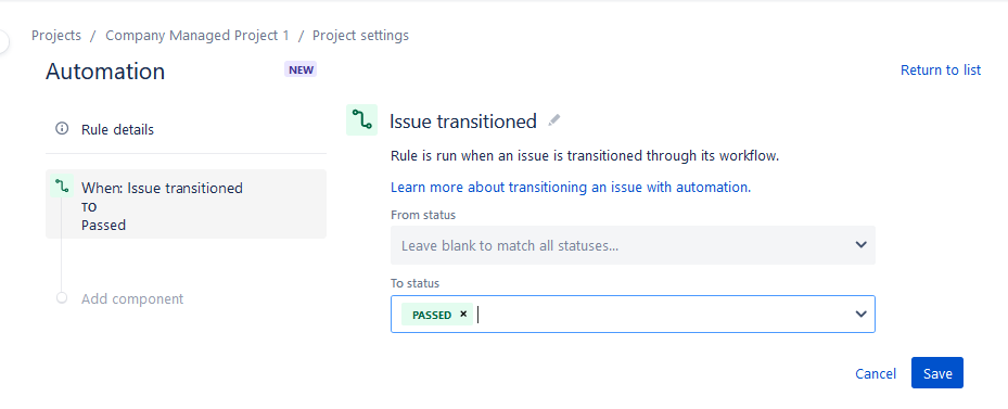

  2.  Select 'Issue Transition' Trigger and then select the status 'passed' in the To status field
  3. Optional we could add a condition to ensure that the ticket type is Test before proceeding. Select 'Issue field condition'.

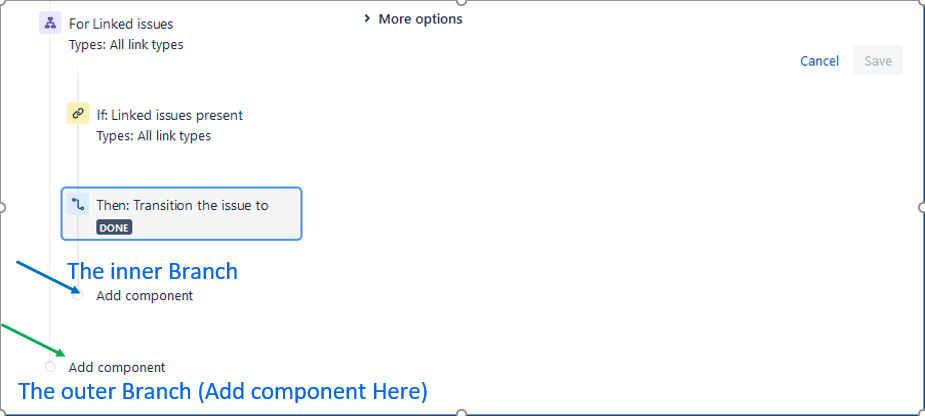

  4. Now we will create a new branch of type 'Branch rule /related issues'. For the 'type of related issues', select linked issues. (you can optionally specify a specific link type)

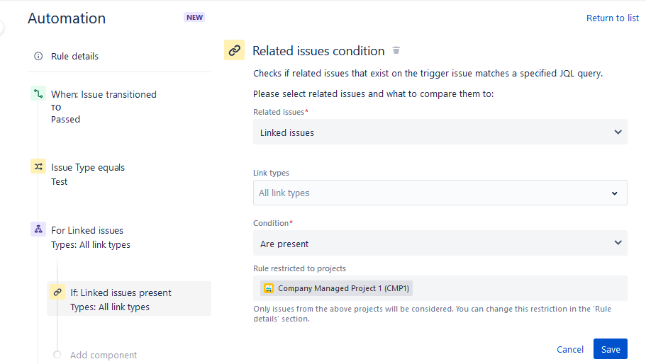

  5. Optional but recommended within the same branch add a condition to ensure that the test ticket has links to other ticket. The condition should be of type 'Related Issues Condition'

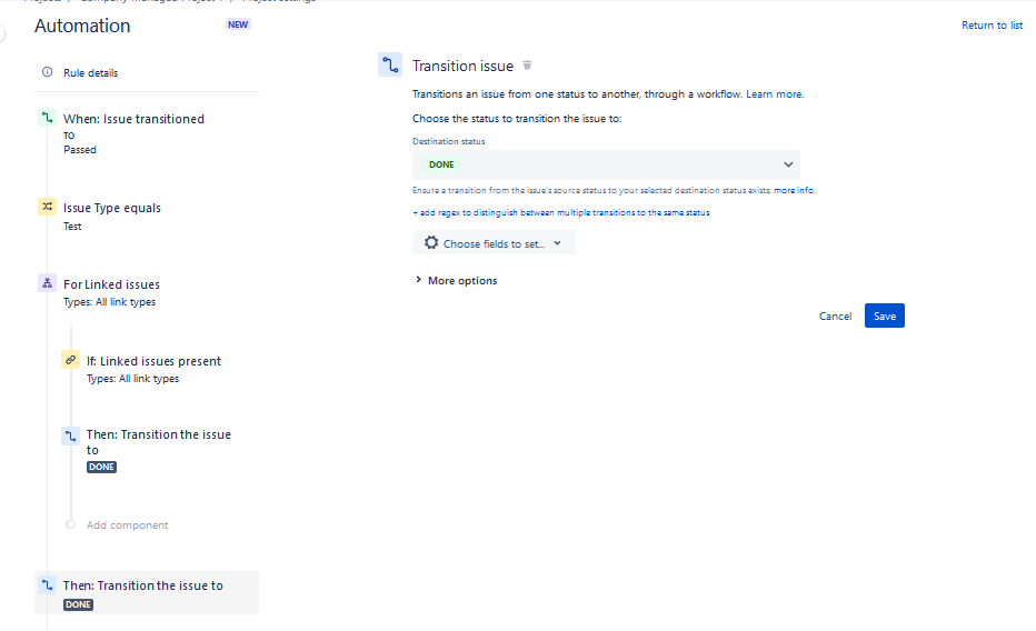

  6. Within the same branch add a new action of type 'Transition Issue' to Done (This will transition the linked issue)
  7. In the outer branch (The main one) add a new component for a new Action of type 'Transition Issue' to transition the Test Ticket to Done (This will Transition the Test Ticket)

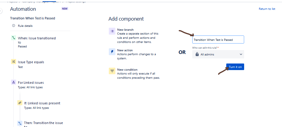

Now Let's Give This Automation a name and Turn it on to test and validate

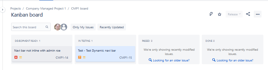

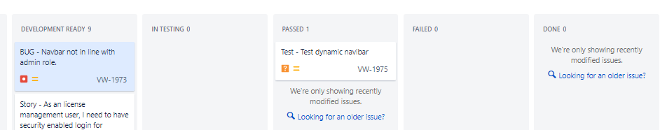

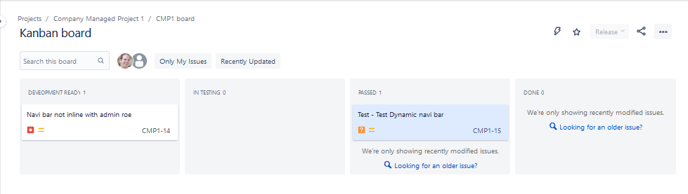

  1. We have the bug now in 'In Development' Status and Linked Test Ticket in the 'In Testing Status' as you see below
  2. Now i will drag the test ticket from 'In Testing to Passed'.

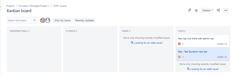

  3. Wait for few seconds and refresh the board. here are the results.
Feel Free to practice and learn, it is really fun. you can enhance the Automation Rule later by marking the tickets as resolved and adding a comment to the Parent ticket that it was closed automatically because the test has been completed successfully.
