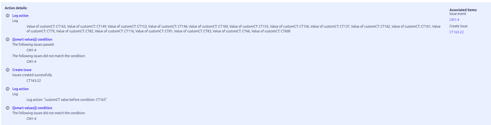

I have added two conditions inside a foreach loop but from the logs, it looks like it is only executing the first condition and then the loop exits somehow or I don't know what's going on after that.
Here is my tree that executes on the update issue
Here are my logs
I am not able to find any potential issue in this. I have also tried the second condition with just the value CT79 and without using trim in the first part of the condition but none works. if I put it as first condition, it then works. It looks like the second condition is not checked after the first condition. I am not getting any idea how it goes.

Hi Ramshaid,
Yes, the If conditions under a branch are not If/Else conditions so if the first condition fails then the rule will stop.
And you can’t put If/Else conditions under a branch. So maybe try multiple branches with the different condition under each branch.

Thanks, @John Funk, for clarifying the point. Could you please point me to some references on how to use branches? I will be dealing with multiple automation processes, and I don't want to keep asking questions here.
John Funk
October 13, 2024
Just use them are you are doing now. Just add a new branch below the current branch and move the second condition and action down under it.

@John Funk Thanks. I got it working.
