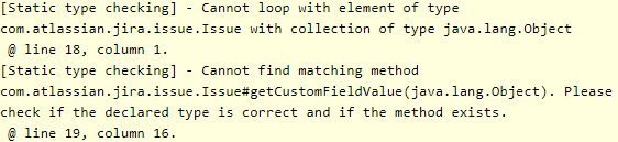

@Jaswanth P
Jaswanth P
August 7, 2019
I am getting the attached error for the new loop statement:
Any thoughts?
Sid
August 7, 2019
@Jaswanth P
Can you post your full code? Also which version of JIRA ?
