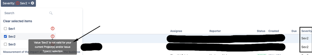

I have a costume dropdown field with 5 selections, when attempting to filter based on one of these values I am met with the error that the selection does not exist even though it definitely does.
Anyone have any thoughts as to why I am seeing this error?

So I tried to replicate your issue, with success it seems. Here is my select list configured with two contexts :
When I try to filter this field, I indeed get the same warning :
But not in advanced mode :
So I would definitely double check in your field context that these values are correctly set for your project. Also note that I am on server.
