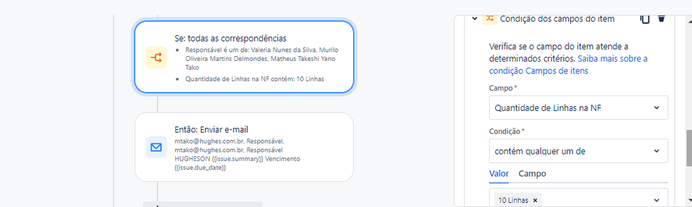

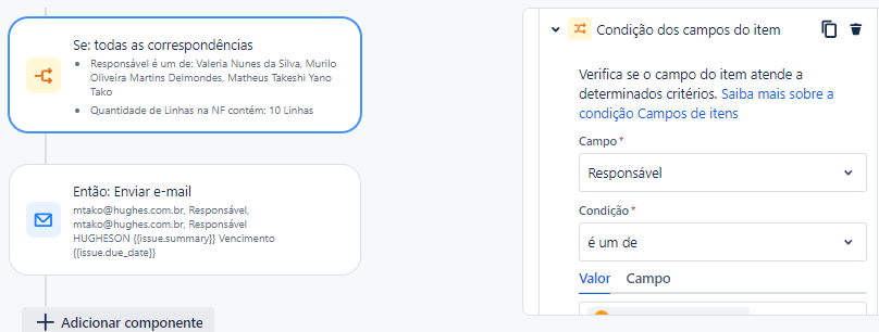

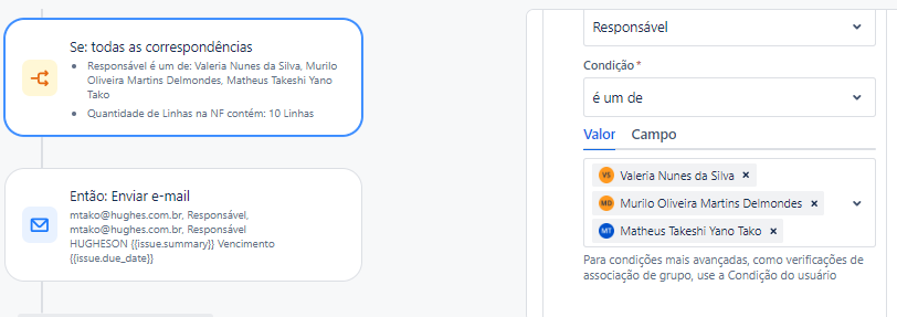

I've structured a set of rules to send an especific e-mail as each issue has it status change to "in progress".
I've been trying different ways to test it but couldn't succeed.
I've run other rules which I received the email sent by the automation.

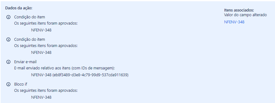

Here are my audit log from this specific rule that I'm testing. Which it says that "E-mail sent to issue's relatives" - So I'm assuming that would be a successful e-mail sent by the automation, but I've checked every folder in my e-mail account and I can't seem to find this e-mail.

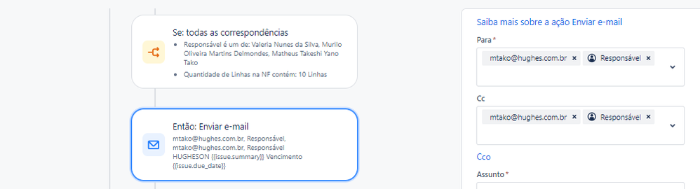

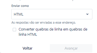

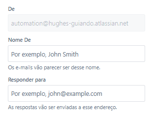

And following below is a evidence of how my send email component is configured. The only thing I've changed is I uncheck the box of "Convert line break to HTML line break":
Since I've tested other rules and it worked, it seems the problem is with this rule. I can't see to find a reason on why is not working.
Somebody please help me.
By the way my language is set to Portuguese (Brazil).

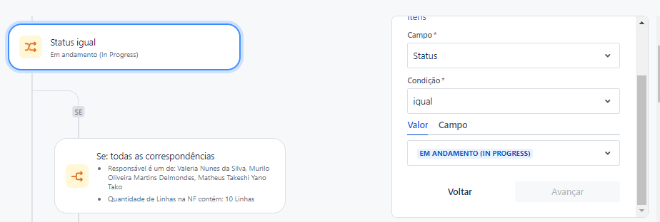

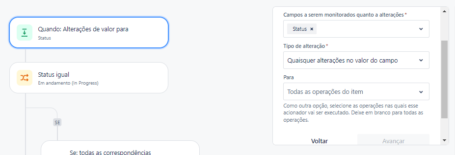

My automation has almost 65 components. So I've created a smaller version to test it out. Yesterday it didn't work out as I wanted.
So Here is the entire automation:

This query creates a table from our issue. This Query is not blocking the e-mail. I've tested this many time and even had the help from other Question I posted in the community. Anyway, This is the entire rule. I can't figure out why I can't receive the e-mail. Which in test I've down a week ago I've received emails.
If you need more information, feel free to ask me.

Trudy,
I do receive notification from another project on jira.
In this specific project I'm not receiving email from automation neither notification.
I've try sending it to other email, and it worked. This other email received.
I think I must have changed some configuration. Since I already look in my outlook account and I didn't block the jira e-mail.
Would you know which configuration I need to change?
Best Regards,
Matheus.
