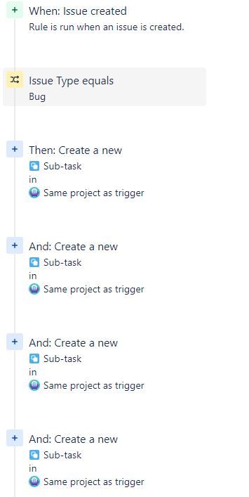

right now I created this automation rule:
so whenever I create a new Issue of type Bug, there are also 4 subtask created.

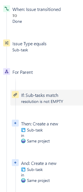

So I gave up trying to block sub-tasks from moving while others are not done. Right now I am trying a workaround, where if 2 sub-tasks are set to done another 2 subtasks are getting created inside of the same issue:
But this does not work also :). Not sure what I am not doing right.
Hi @thrilos07
It seems like there might be a problem with the issue type checks here. Can you confirm what the audit log is saying when the rule executes? If I am understanding your situation correctly, you are wanting to fire the rule off when a sub-task of a bug is transitioned to "Done", and then check if the parent bug's sub-tasks are all Done as well. With you current rule, the first check will be checking the triggering issue's type is bug. However, the triggering issue type would be a sub-task, not a bug, so this should fail. The same goes for the check in the branch's condition as well.
Can you try changing the first condition from "Issue type equals Bug" to a Related Issues Condition, and in that check the Parent matches JQL "issuetype in ("Bug")". Then remove that part of the branch's condition (just set the branch's condition JQL to "status = Done").

Hi @thrilos07
according to your requirement:
I was able to build a rule in my Jira Cloud which meets your requirement.
It is tested and it works - probably there is a more elegant way, you could check.
Most parts are easy, for the "If: Sub-tasks match" "resolution is not EMPTY" part the Condition is "All match specified JQL".

This is exactly what I was looking for!!
Thanks Daniel!!
