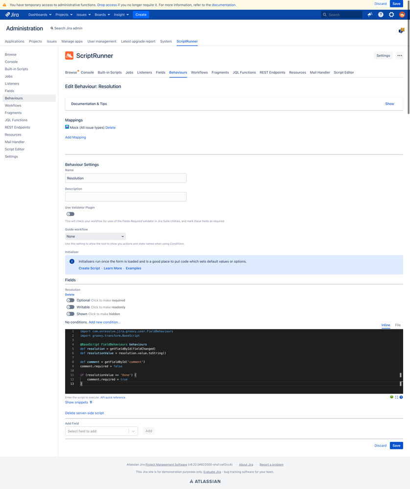

For your requirement, you need to use a Server-Side Behaviour for the Resolution field to ensure that the Behaviour will trigger only when a change is made to the Resolution field.
Below is a sample code for your reference:-
import com.onresolve.jira.groovy.user.FieldBehaviours
import groovy.transform.BaseScript
@BaseScript FieldBehaviours behaviours
def resolution = getFieldById(fieldChanged)
def resolutionValue = resolution.value.toString()
def comment = getFieldById('comment')
comment.required = false
if (resolutionValue == 'Done') {
comment.required = true
Please note that the sample code provided above is not 100% exact to your environment. Hence, you will need to make the required modifications.
Below is a screenshot of the Behaviour configuration for your reference:-
