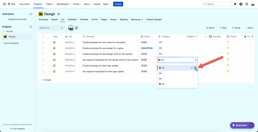

@Elif Alverson the reason you have three options with the same value is because they may look the same but they are not. Your third options has different coding (it has ???? at the beginning instead of US flag) and either your first or second options has a space at the end.
To remove two of those options follow the steps below:
  1. Go to your project > List tab
  2. Edit an issue's category field
  3. Find the options you want to remove
  4. Click on Delete icon

  1. First you will need to filter out your issues to the categories which you want to remove (In the list view click on Filter > Select the categories you want to remove)
  2. Then change their categories to the category which you want to keep
  3. Finally once you confirmed the old categories are no longer used (repeat step 1 and make sure no issues are returned for the old categories) then remove them
