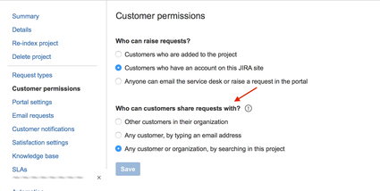

The attached image shows you who customers can share issues with.
