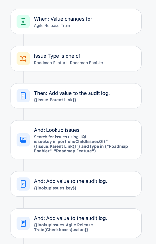

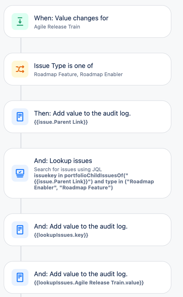

So, start a new rule with:
Please cross check my JQL for lookupIssues...

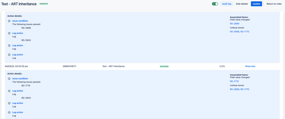

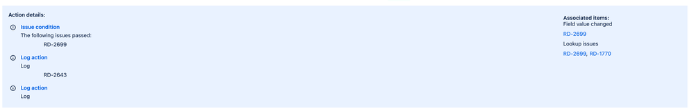

Create this rule, trigger the rule by adding/remove a value from the check box field and share the audit log. We need to see if lookupIssues gets all features/enablers
It looks like it found all the child issues as you can see with the linked issues above. Those are the only two under that particular parent.
However it didnt update the parent to reflect the changes made to the child. Im assuming I missed a then statement to say update parent?

In your rule, can you next log {{lookupIssues.Your Field.value}}
Replace bolded part above with actual field name.
Then, select few values in both the features, preferrably duplicates..
And share the audit log again.

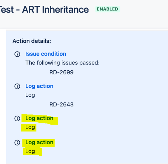

Ok I added the same value to the field on each of the child tickets, here is the audit log
Can you share your rule screenshot as well. As you can see, last 2 log statements are not printing correctly so something if off..
Also, make sure {{lookupIssues.Your Field.value}} has your correct field name...

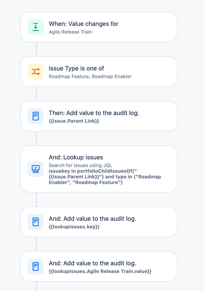

2 things.
Please use lookupIssues, not lookupissues... (capital I instead of lower case i)
So change it to {{lookupIssues.key}}
And the last lookup, change it to {{lookupIssues.Agile Release Train.value}}
Please update both, trigger rule by adding a check box field and share audit log. Thanks!

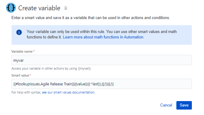

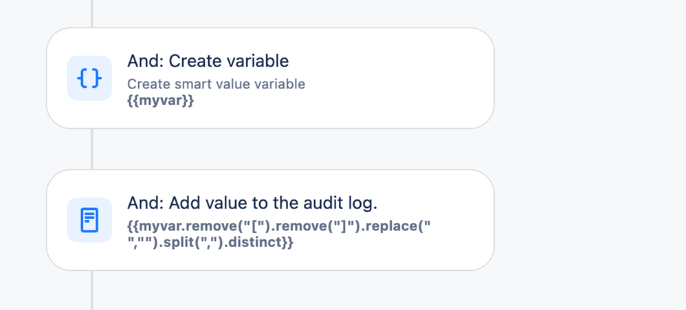

Great. I am going to list down series of next steps. I am not in front of computer right now so Please implement them and share screenshot of the rule and audit log as you go long to understand issues.
Next:
{{#lookupIssues.Agile Release Train}}{{value}}{{^last}},{{/}}{{/}}
"fields": {
"Agile Release Train": [ {{#myvar.split(", ")}}{ "value": "{{.}}" }{{^last}}, {{/}}{{/}} ]
Trigger rule by making change to a field and share rule screenshot and audit log:

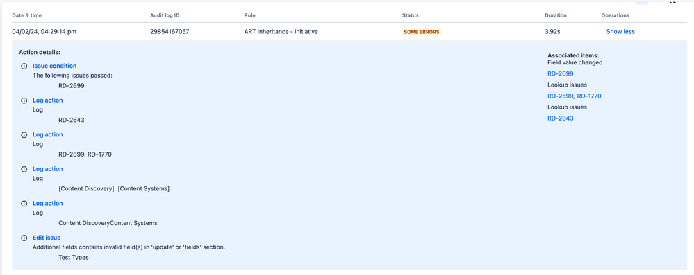

Looks like were pretty close, its pulling everything in accurately to the Log but failing to add it to the parent. But as you can see from the last Log Action there is no space between the two variables, could that be the issue?
Yes, those values should be separated by commas.

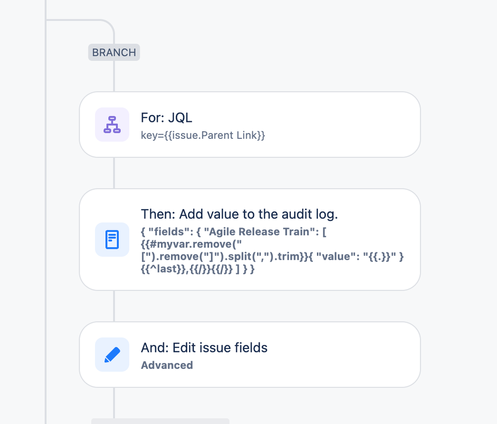

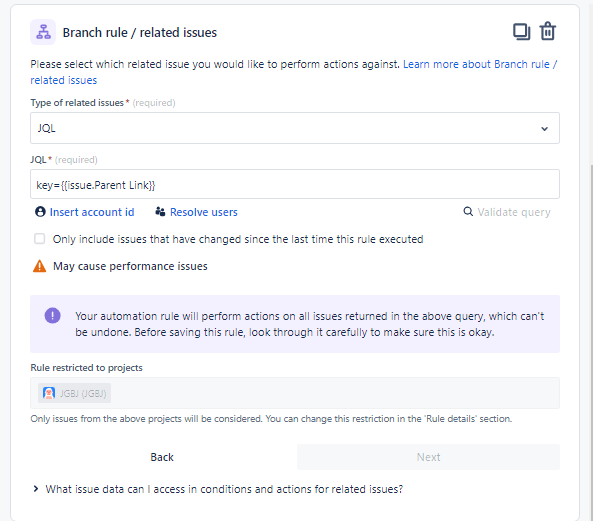

So there are few corrections I had to make. So please delete earlier steps and please redo like below:

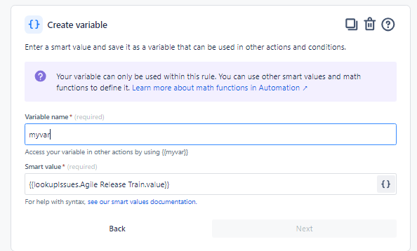

your variable myvar should be:
Then do branch -> Choose JQL and give query = key={{issue.Parent Link}}
Then do a log action and log below value to verify:

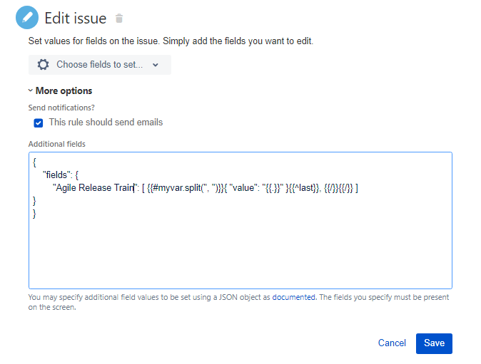

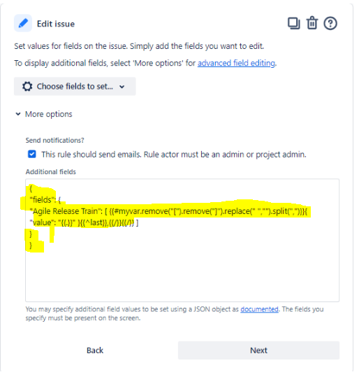

"fields": {
"Agile Release Train": [ {{#myvar.remove("[").remove("]").replace(" ","").split(",")}}{ "value": "{{.}}" }{{^last}},{{/}}{{/}} ]
Then edit issue -> Additional Fields - Remove existing JSON and replace with below:
"fields": {
Your last few steps should look like below:
Please clear steps from my earlier post and implement these from the "Create Variable" step onward, trigger rule and share audit log if issues.
*fingers crossed*

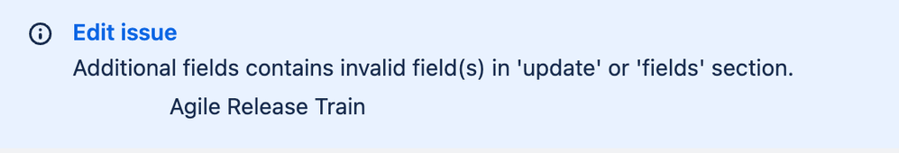

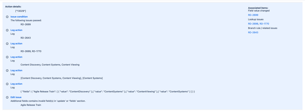

looks like were hitting a similar snag. Seems like it errors out with the Additional Fields query.

"fields": {
"Agile Release Train": [ {{#myvar.remove("[").remove("]").split(",").trim}}{ "value": "{{.}}" }{{^last}},{{/}}{{/}} ]

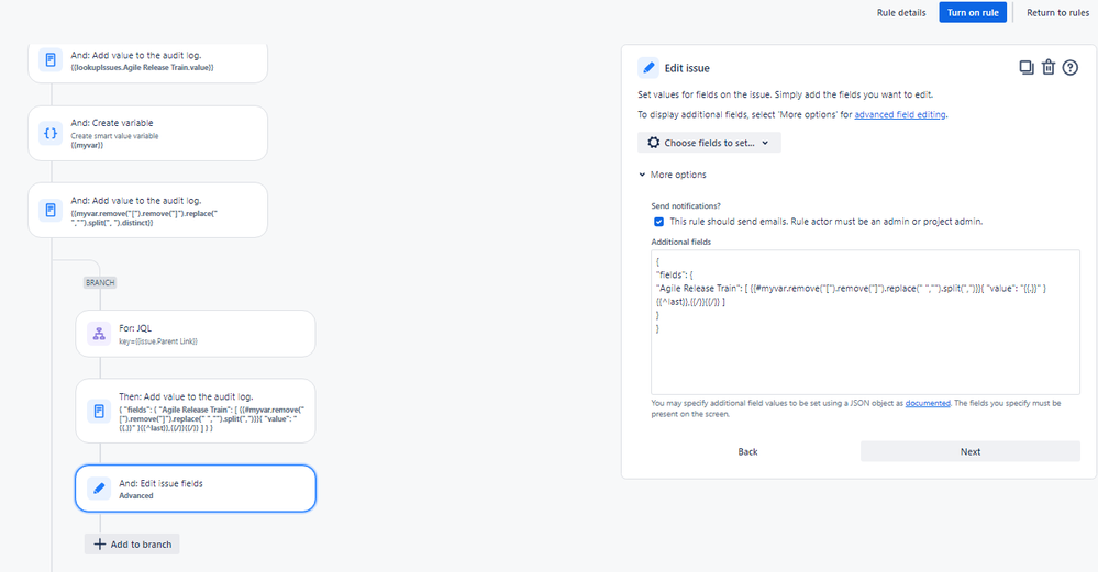

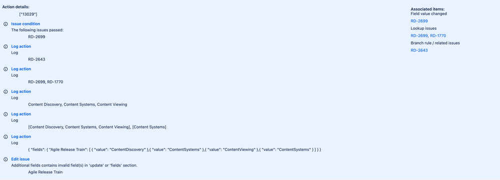

No need to apologize at all. Youre an absolute rockstar and I appreciate your help greatly! I spot checked everything and Im still getting the same error. Let me drop the latest audit log and a screen shot of the flow for reference because I know im missing something small
Can you Please share screenshot of the details of the edit issue fields screenshot which shows the JSON?
OK, so every thing is correct.
Only thing I can think of is, in the edit section. the field "Agile Release Train" is not working.
We need to find the custom field value for this one.
If you dont know this value already..
https://yourdomain.net/rest/api/2/issue/RD-2643?expand=names
Please refer to this process for details on this step:
https://support.atlassian.com/cloud-automation/docs/find-the-smart-value-for-a-field/
And once you find it.. replace "Agile Release Train" with that value in edit section, something like below:
"fields": {
"customfield_XXXX": [ {{#myvar.remove("[").remove("]").split(",").trim}}{ "value": "{{.}}" }{{^last}},{{/}}{{/}} ]
Since its late, maybe we can tackle this tomorrow. Sorry it ended up being marathon.. I wasnt on my other machine earlier..
That was it!! Just needed the custom field id and now its working like a charm!!
