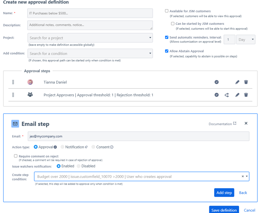

If you are open to using an app for approvals, many of them have conditions that you can apply for any approval (or even the approval step). In your case, I'd prepare an approval definition like this:
  1. A person (or a group) who always has to approve, no matter the field's value.
  2. A person (or a group) who approves only if the condition is met (field value >X).
  3. A person (or a group) who approves only if the condition is met (field value > X).

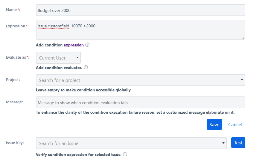

To show the solution on an example - here I created a custom field for budget (with ID = 10070), so the condition looks like this:
and the whole approval definition can be:
I hope it helps ;) The app I'm using is Approval Path for Jira, which allows approvals not only for JSM (you can check it out here ).
