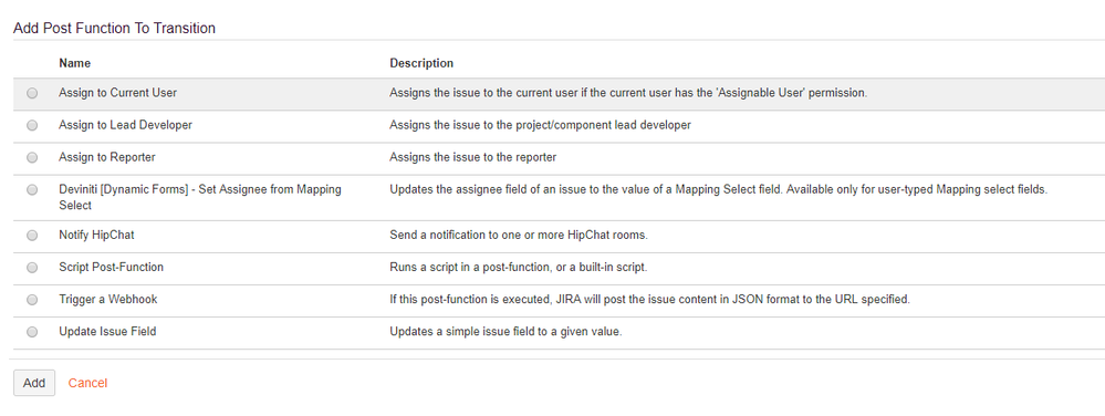

Hello Petterson,
Unfortunatly i didn"t have this post function. All i get is describ in the following picture.
