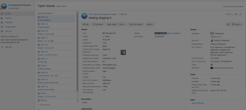

When I try to transit issues from status New to status In progress (transition Start Progress), screen becomes grey and nothing else happens. The problem repeats for each user of this particular project, other projects work correctly.
Do you have any ideas, why can it happen? And what can I do to fix it?

This is not my own screenshot, but I see absolutely similar picture. After reloading page screen becomes normal again, but issue status doesn't change.
