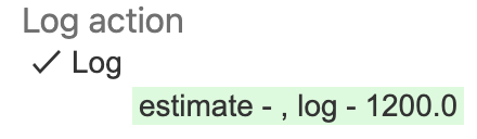

I've done it and it seems {{issue.originalestimate}} returns nothing
ok, now I understand. It was a simple mistake, since smart value for Original estimate should be issue.timetracking.originalEstimate

@Trudy Claspill Hi! Unfortunately, what I've done above after you kind advice didn't resolve an issue. I've managed the syntax thing and now I have both fields in automation rule to show perfectly.
Still the rule performs even if logged time is less that original estimated. I'm afraid this is because of format difference showed below.
Would be thankful for ideas on how to edit Groovy formula to make my custom field return the value of logged hours in the same format as Original estimate.

What are the smart values you are using when printing "estimate" and "log"?
estimate - {{issue.timetracking.originalEstimate}}, log - {{issue.fields.dev-total}}

I don't have a data center instance to try this, but what if you use originalEstimateSeconds instead of originalEstimate?
Yes!!! Couldn't imagine to solve this from such angle. Thank you so much!
