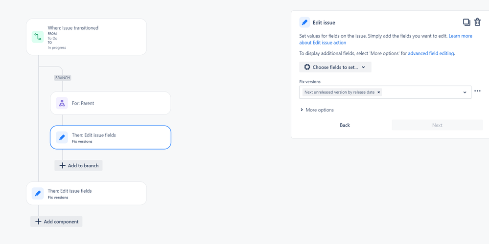

Hello community! I have an issue with Jira automation. I set up the rule: when issue status transition to "in progress" then edit issue field fix version (next unreleased version)
But I have a few versions now. So...
And when automation works it just deleting that version which I set up by myself and setting up next unreleased version. How can I set up a rule so that it doesn't delete the second version that I put on it?

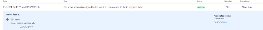

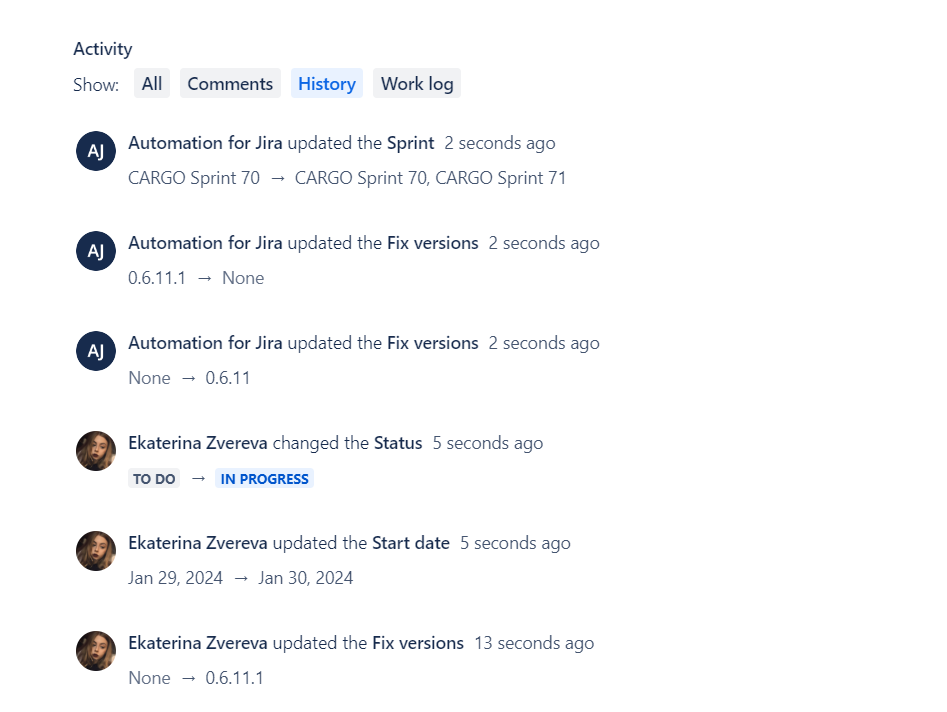

Here it is, my rule and history about how it works image.pngimage.pngimage.pngimage.png

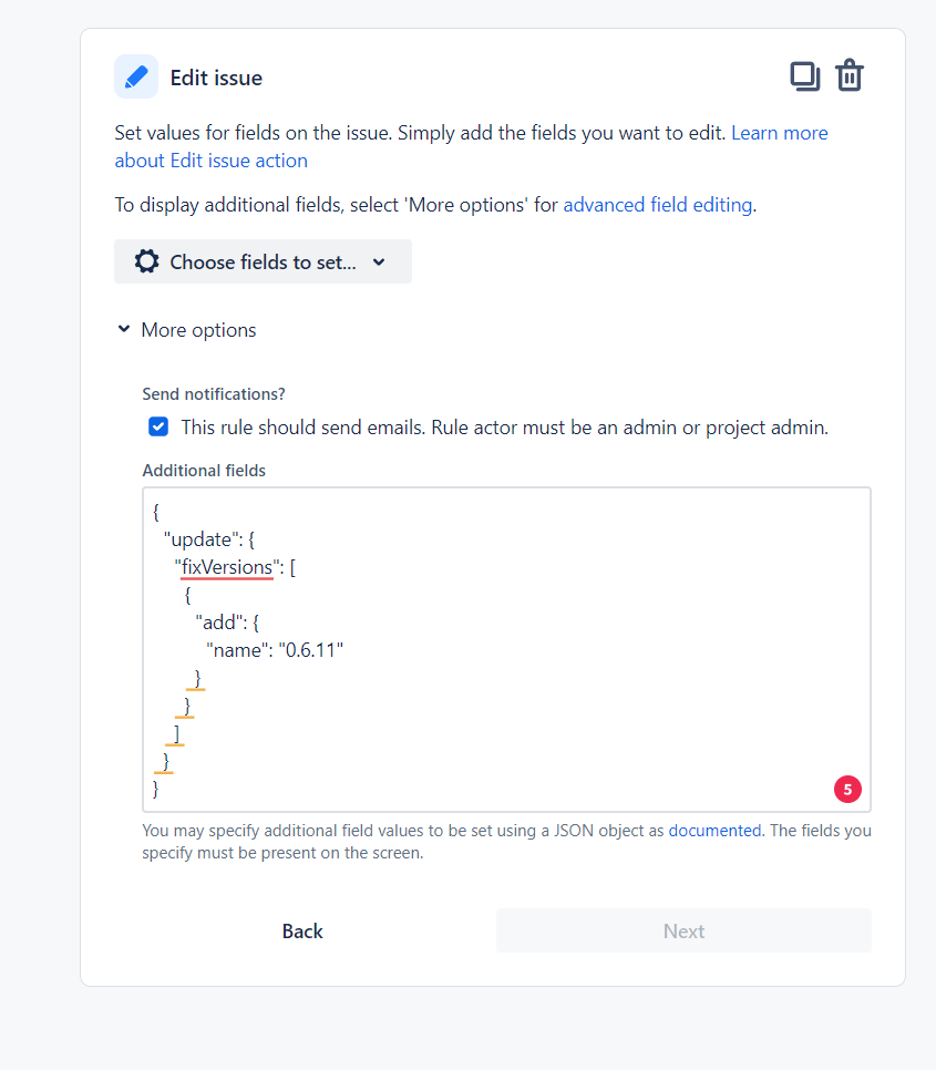

@Bill Sheboy by JSON I did this, but as I understand I should every time change name of version in this rule image.png

Thank you for that information.  Focusing on the original rule first:
Looking at the audit log from your rule execution, I see only one Edit Issue result, indicating there was no parent issue to branch to.  Is that what you expected for the issue CARGO-5488?

Given what appears to be the change history for issue CARGO-5488 there are at least 2 rules running on that issue after the transition: one changing the Fix Version and another changing the Sprint.
Ekaterina Zvereva January 30, 2024
I have two similar rules set up, one for automatically transferring a task to a sprint, the second for automatically assigning a version to a task.
And I expected that the version that is already specified in the task will not be deleted by this second rule which I attached above.
I don't see a problem in the logs. And I solved the problem thanks to your hint with JSON :)
Now two versions are displayed in the field and the one that was already in the task is not deleted. But now I need to change the version name in the script at the time. Otherwise, the task will always be assigned version 0.6.11
So this method partially solved my problem, but didn't fully automate the process.

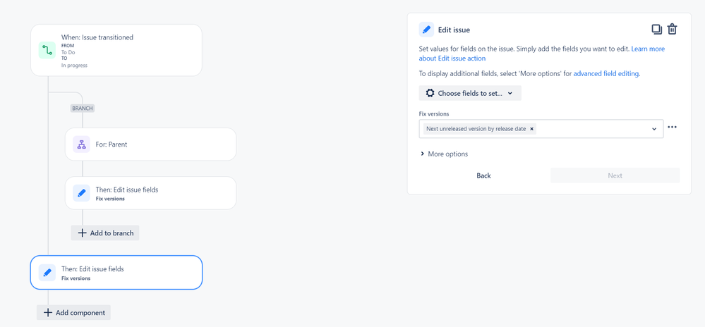

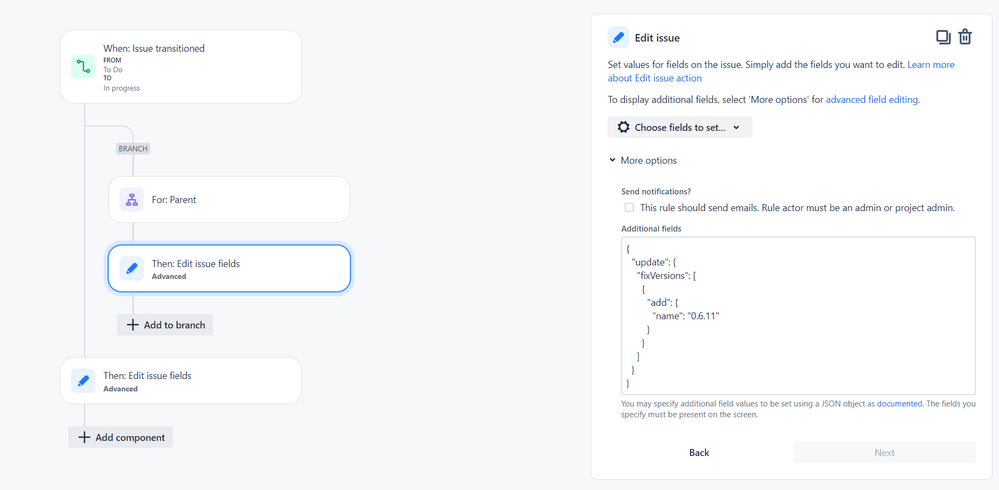

Thanks, and that shows your rule can successfully add a hard-coded version to the existing ones.  But you want to add the "Next unreleased version by release date".
There are a couple of ways to do this: two updates or one update using data from the REST API functions.  The second one is more difficult, so let's try the first one...
The idea is to save the current value for the version in a created variable, set to the next unreleased, and then add the saved value.  I will add italics where there are changes for your rule:
