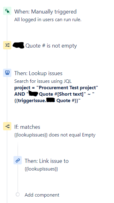

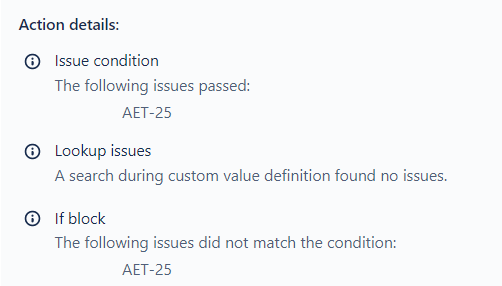

I've created a manually triggered rule, however, it is not working as expectedScreenshot 2022-11-29 193328.pngScreenshot 2022-11-29 193715.png
The rule is to check for the same quote # and link if there is a matching quote #. When I run this rule manually, it is not giving the desired result. There is a matching quote # in the procurement test project, but the lookup returns empty. Please help

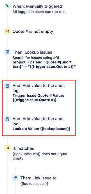

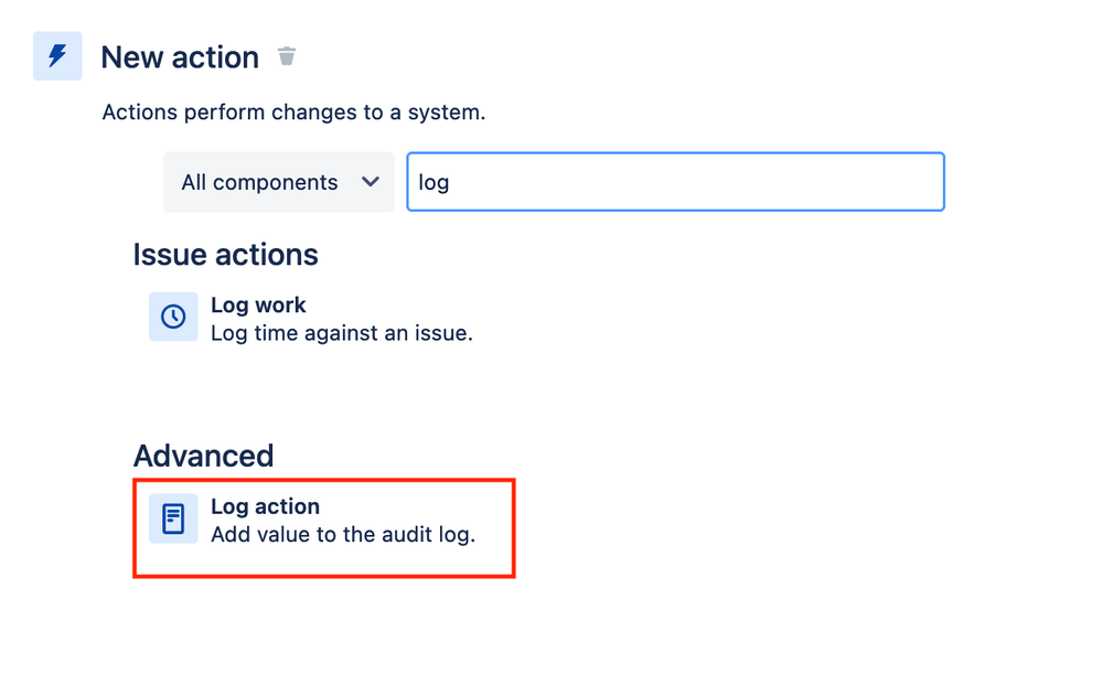

Certainly. So the action you would add is the 'Log action' action.

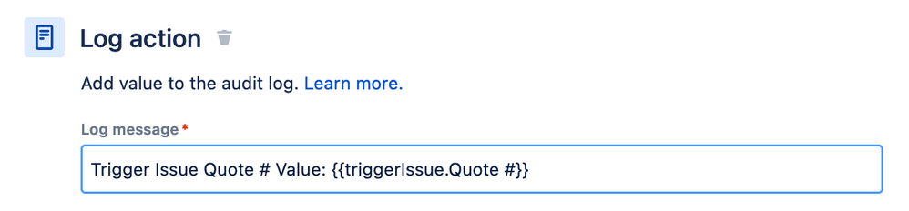

Then you type out a message to include in the log and specify the smart value, I usually do something like <Name of the Smart Value>: {{SmartValue}}
You'll want to add this action to your rule after the variable has been stored in the smart value. I typically do it before the smart value is used so it's in line with what I'm looking for:

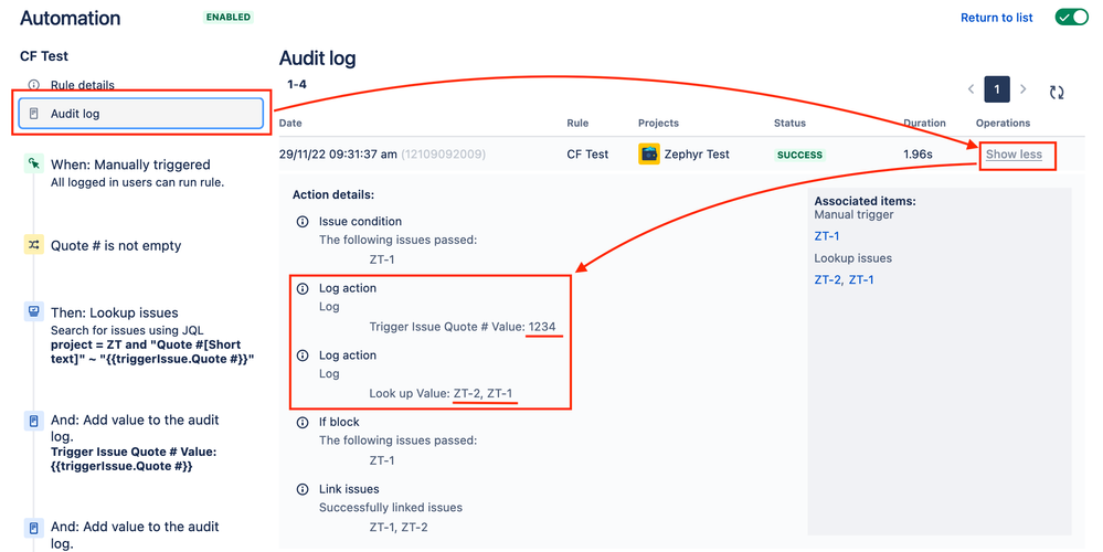

After you run the rule navigate back to the rule edit page and click on the Audit log -> "Show More" and then look for the 'Log action' lines that you previously configured.
