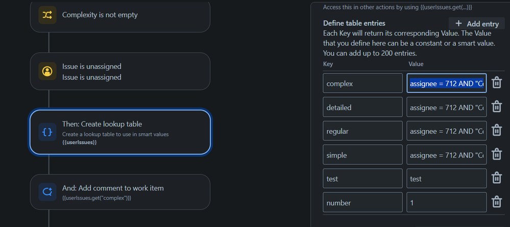

I've been asked to create a load based automation slightly different from the load based one that Atlassian currently offers.
Basically, the user wants the tickets to have a "weight" based on a field that they enter, called "complexity".
Weights are 1,3,5,etc.
They would also like the automation to not assign tickets to users if their ticket load is over 30.
I've been messing with jira smart values and jql summaries for a bit and was wondering what the best way to do this would be.
I'm currently stuck with a lookup table to reference all of the jql for the first user
the value is {{assignee = (firstuserid) AND "Complexity[Dropdown]" = Complex}}
This is the jql query that will tally how many work item issues are assigned to each user based on complexity, so that I can do the math for the weight load with it and not assign it to the user if the weight is above 30.
I've tested it to comment on the work item, but it says that the value is empty.
I've also tried it with the raw JQL but it just returns the string of the actual JQL instead (assignee = (firstuserid) AND "Complexity[Dropdown]" = Complex)
I think the jql I'm putting in might be wrong or might not be able to be parsed by the lookup table, but any help is appreciated thank you!

Hi @Evan Kaung -- Welcome to the Atlassian Community!
Without seeing your entire rule for context...I am not following how you are trying to use the Lookup Table.
When a Lookup Table is created, the Keys are static values and the Values can be static or dynamically determined at the time the table is created.  The Values must also use valid smart value (or plain text) syntax.  The syntax you are trying to set the table row's Values is both incorrect for a conditional expression and likely not what you seem to be describing.
Please show an image of your complete rule, in one single continuous image, and perhaps explain your scenario with an example work item and how the rule would process that.  Those will provide more context for the community to help.

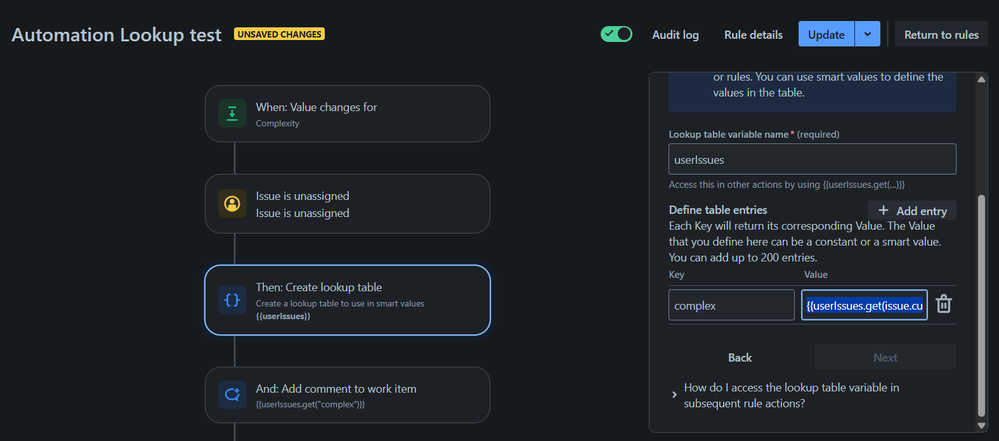

@Evan Kaung , Welcome to the Atlassian Community!
I'm assuming that your complexity field is a select field for this case. This way, here how you need to use the lookupTable resource in the correct way.
Considering your table is called {{userIssues}}, your smartvalue to get the value considering the complexity reference should be: {{userIssues.get(issue.customfield_XXXX.value)}}
Change XXXX for the correct ID for the complexity field.
Using this you will able to get the value considering complexity reference.
Hope this helps you :)
