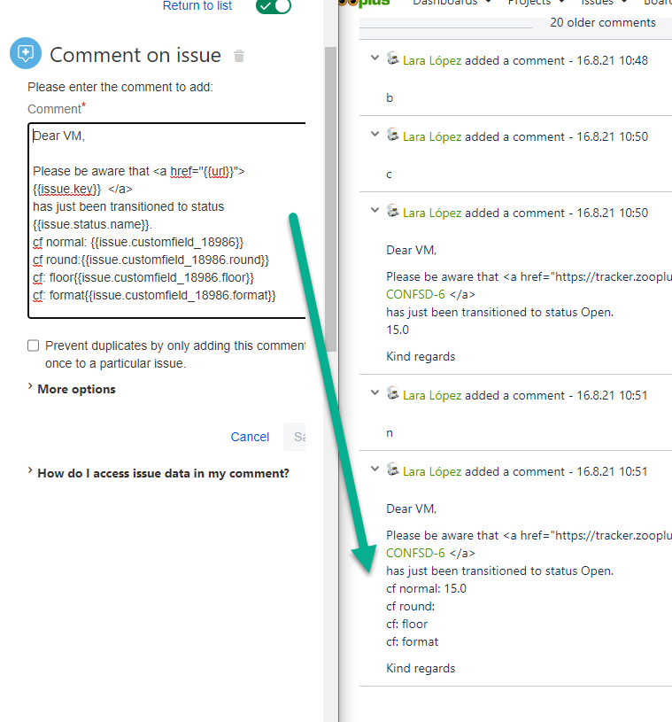

Hi @Lara Lopez
With automation for Jira, you could use a math expression to round() or floor() the value to the nearest integer, or you could use the format command to only include the integer part:
Best regards,
Bill
Interesting... I rechecked and all of those functions work as documented for me. Please note that for format() you need to provide a format string, such as .format("#")
And, I noted you are using Server version, so let's try this syntax:
{{#=}}FLOOR({{issue.customfield_18986}}){{/}}
