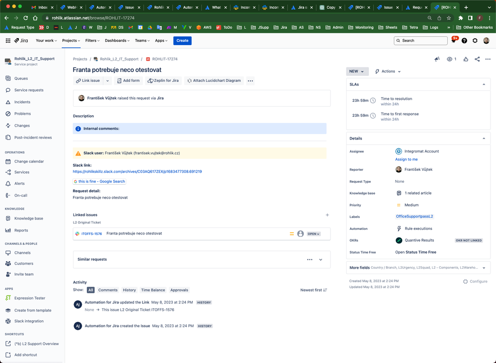

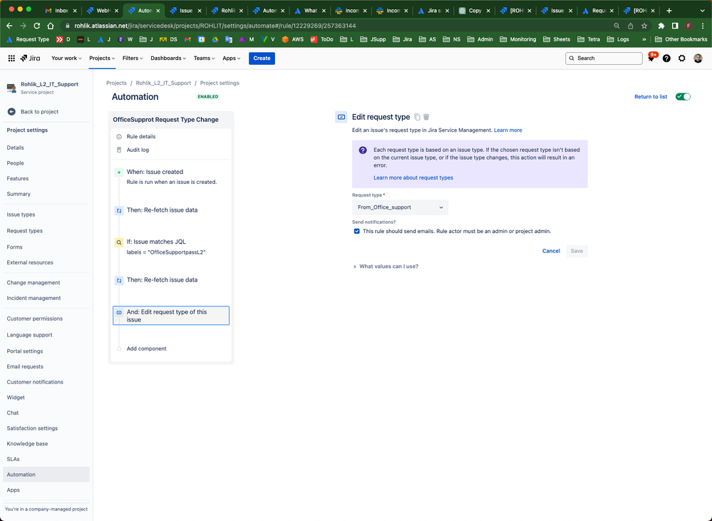

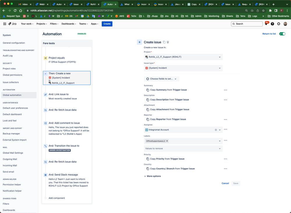

I have created the rule which is creating a new issue in another project and it can't pair a request type on it -.- so i said to my self OK, i will add it in another automation in the second project. But there is NO trigger which would trigger the action after the issue was created with that previous automation in other project.

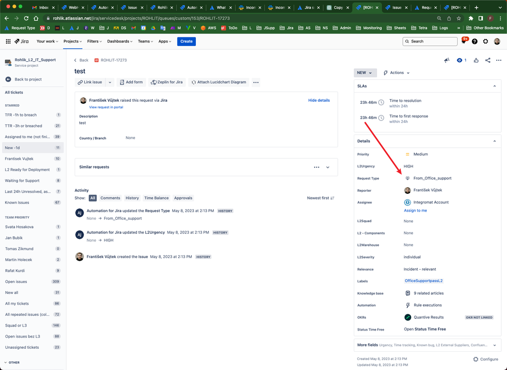

Simply it wasn't taking any action. So i have create a ticket manually via create button on the bar in jira and it was working.. -.-
So, the jira automation is making a difference between ticket which has been created via automation and the tickets which have been created manually. Thats no sense. I have spent last 4 hours figuring why my triggers and automations are not working and this is the reason.

When you will set a trigger When issue is created, it will do NOTHING. When the automation created the issue from other project.
But if you will create it manually, it works. There must be something wrong.Snipaste_2023-05-08_14-26-51.pngSnipaste_2023-05-08_14-27-27.pngSnipaste_2023-05-08_14-27-49.pngSnipaste_2023-05-08_14-28-02.png

Ok so i have the solution.. -.- It because i didnt have checked the rule can be fired after that previous rule has been shot from another project.
