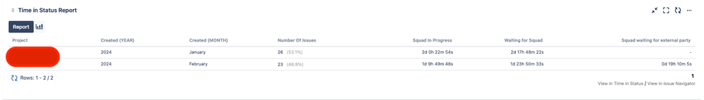

Thank you for your response and for taking the time to craft it—it's truly appreciated.
I've just acquired the Time in Status feature, and I'm excited about its potential usefulness!
However, I'm curious if there's a way to generate a total automatically instead of having to manually calculate all the numbers. While I can see the percentages in the reports, I'm unable to find a way to display the total hours spent in all three statuses.

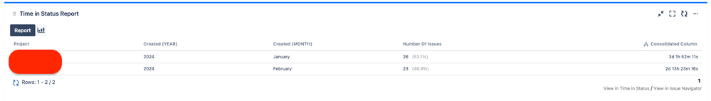

From the screenshot you've sent, I understand that you are using the Status Duration report. In this report I suggest you use the consolidated column option. From the Status menu above, you can add a consolidated column and select the statuses you want to combine. The report will then automatically sum them up. You don't need to do any manual calculations, we do them for you!
