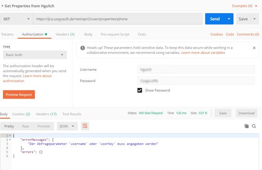

Hello Petterson,
thanks for your reply but that is not working for me. Here is what I did (same you put, but not /3 - I needed to put version "2" instead (my Jira is 7.12.1)
It says that username oder userKey are required - so I added the parameter

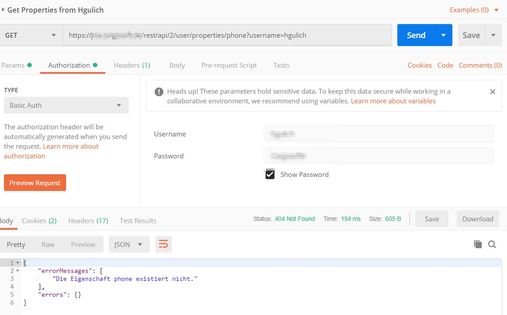

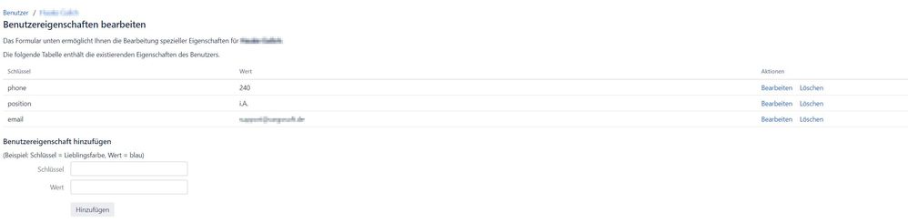

It says that the property "phone" does not exists, but when I open the user properties of hgulich it is like this:
(sorry for german screenshots)
I don't get it :-(

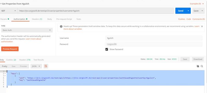

Hello Hauke,
This is odd. What property keys are returned when you run the query below for the user hgulich?
GET /rest/api/2/user/properties
If it returns any keys, try to put it in the URL using the same format.
Analyzing the Rest API documentation for JIRA 7.12, I also found the following warning:
Returns the value of the property with a given key from the user identified by the key or by the id. The user who retrieves the property is required to have permissions to read the user.
Can you double-check if you are running the REST API with the same user you are using to check the user properties in the UI?

Hello Petterson,
thanks for your support. I get the following result (kind of strange result)
I have no idea what "lastViewedVignette" means. I am using hgulich to authorize against the REST API. Do I have to use a different authentification type?
