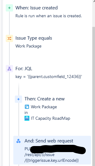

I'm trying to retrieve the key from a created issue to fill a custom field in the trigger issue.
Trigger and Created issues are in different projects and are sub task types
Problem is that I need to branch it to retrieve data from the Created parent issue to gather the key of a previously created issue that will be the parent of the new one in a different project)
Trying so many ways API seems the direction but I get a 405 whenever i try to use smart values in the URL.
Any clues?
Thanks in advance

If I change {{issue.parent.key.urlEncode}} to for example ABC-1 it works

Yep, I'm trying to use the re-fetch , seem that it's going that way but also i am not pointing to the right one.
Parent issue ID: '616621' / Key: 'ITCR-68' can not be sub-task. (issuetype)
It seems it's taking the Trigger as the one created in the branch, and what I need is the
very first one in the image flow above

If you want to update the trigger issue, I recommend changing the rule as follows:
What do you think?
Hey Bill, thanks for the answer,
it looked good but i've still got the same error following that flow

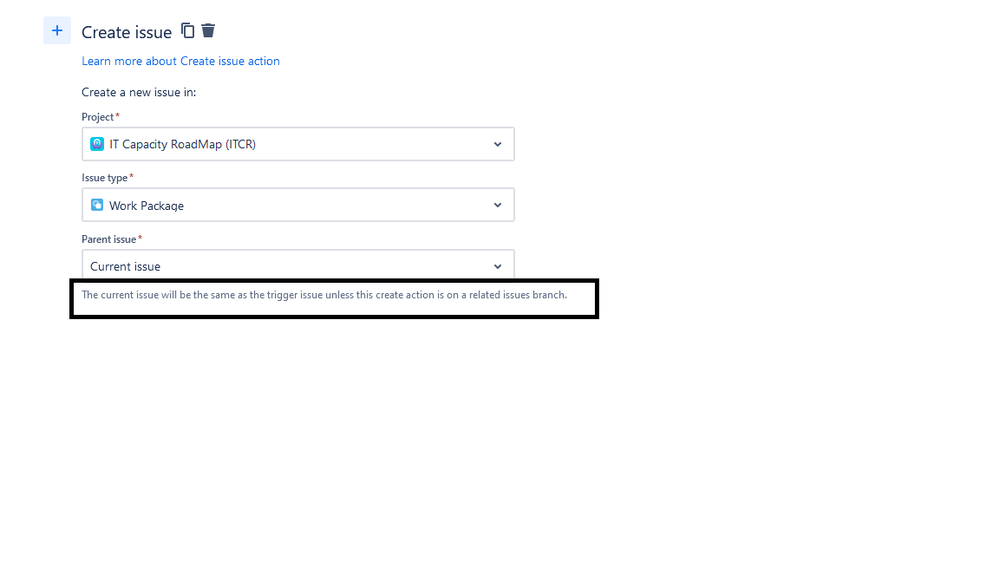

Create issue
Error creating issue
Parent issue ID: '620343' / Key: 'RCPM-506' can not be sub-task. (issuetype)
I think that if Branched is not used, it will try to create the subtask in the trigger issue not in the lookup one
Rather than selecting Current Issue for the parent field, please type in the smart value for the key you want to use.
When you do that, the key will appear below the field, and then it may be selected for use in the action.
it seem that this drop down only allows to choose between current and trigger issue, no input for variables.
Neither the current or the trigger will be the parent in this case
The UI for the rule edit is not clear on this feature...
Hi Bill,
I was referring to the create, not to the edit . In the create one only two options are available and no way to input anything.
