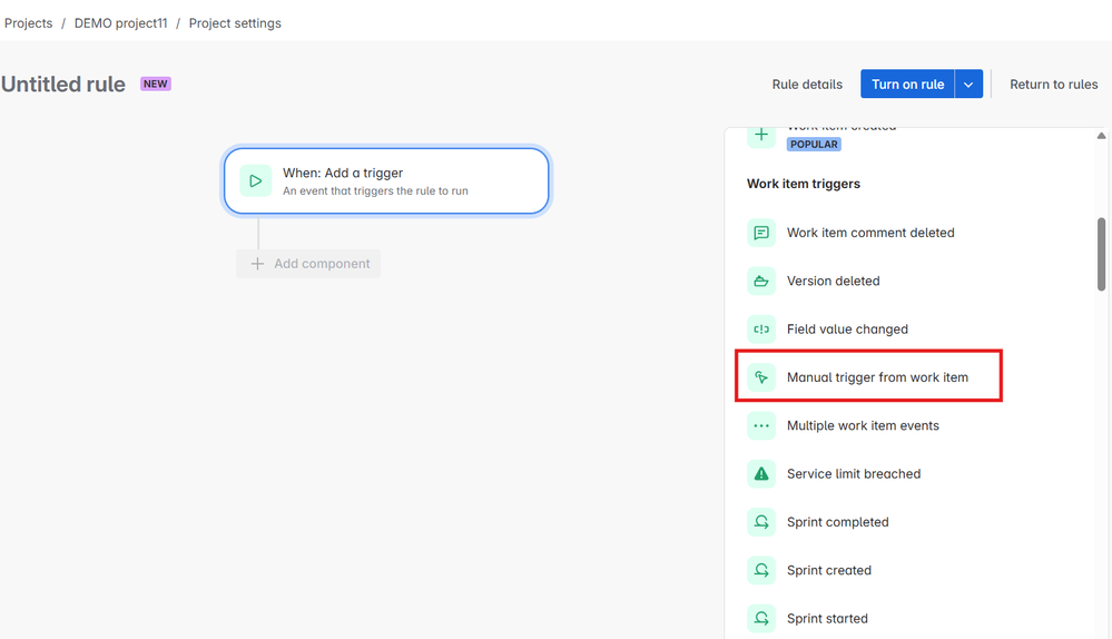

Option 1: Use “Scheduled Trigger” with JQL
Option 2: Create a Manual Trigger (Global or Project)
you can use this Triger in your automation rule.

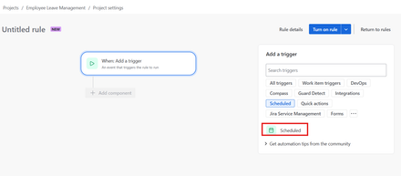

Thanks for the reply. Could you please explain more about Option 1:-
Where is this option and how to configure it?
Ashok Shembde
July 4, 2025
  • Go to your automation rule.
  • Click on "Add trigger" → "Scheduled".
  • Select “Run a JQL query” and enter your JQL filter to select the old issues. Example:
  • project = ABC AND issuetype = Bug AND created < -30d
  • Set it to run once or disable the schedule after first run.
