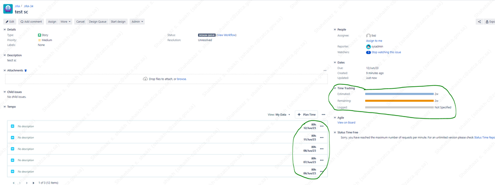

Hi Community, I am having some difficulty getting the code to work for auto creating tempo plans to users based upon getting assigned.
I referred following link - https://library.adaptavist.com/entity/create-tempo-planning-information-when-issue-is-assigned
for my use case.
Use Case: Auto create tempo plans with Time Tracking and assigned user
However when i am assigning issue to a user i am getting following error:

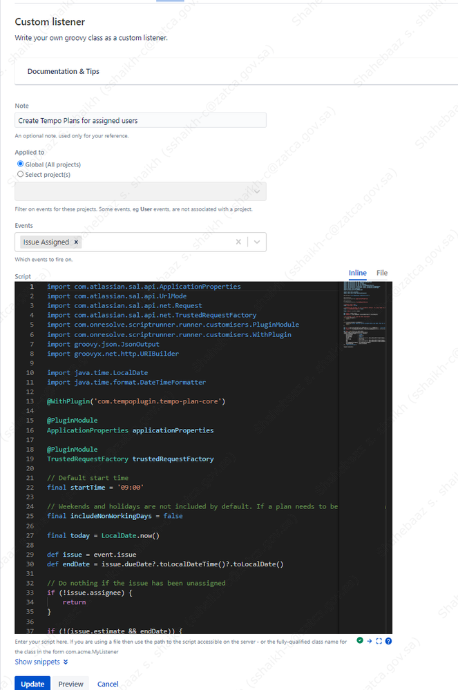

Hi @baz89103
The listener appears to be complaining about the event. Could you please confirm which event you have configured for it?
It would be helpful if you could share a screenshot of the Listener configuration.
I am looking forward to your clarification.
Thank you and Kind regards,
Ram
Thanks for the reply @Ram Kumar Aravindakshan _Adaptavist_
I have configured Issue assigned event, adding snapshots

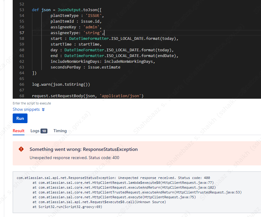

So basically you need to debug why the endpoint gives you a 400
com.atlassian.sal.api.net.ResponseStatusException: Unexpected response received. Status code: 400
at com.atlassian.sal.core.net.HttpClientRequest.lambda$execute
at Script1.run(Script1.groovy:59)
Where groovy:59 refers to your line, the last command in this stack is an execute closure. Putting 2 and 2 together this refers to the method 'requet.execute()' in your code.
So, you're sending data to the endpoint, and it returns 400 as a reply, and for whatever reason the http client underneath the "request" throws an exception because of it.
I can't tell you why that is, but probably something in that json is no likey. You should otherwise get a 403 or something if it was not authenticated, but if it gives 400 then the request went through, got to the endpoint, but the endpoint decided something is invalid, so again this makes me think it's something with the data.
So personally I would just take that code apart and only debug the http post, then put it back after finding the flaw.
You also might want to compare the json data with the actual documentation - https://www.tempo.io/server-api-documentation/planner#tag/Plan/operation/postPlan
The script in library was written at some point in time, possibly for older versions, so it is quite likely you need to update the template for that endpoint to work.

You can just change the issue key, everything else is fine, put it into console, run it, and then switch to Logs to see what's in the json before it's sent to the endpoint.
In my test case, I get:
{"planItemType":"ISSUE","planItemId":3086710,"assigneeKey":"admin","start":"2023-05-24","startTime":"09:00","day":"2023-05-24","end":"2023-05-25","includeNonWorkingDays":false,"secondsPerDay":28800}
Now, compare this with the documentation - https://www.tempo.io/server-api-documentation/planner#tag/Plan/operation/postPlan
What I see from this is:
Otherwise all other required fields are there, in right format.
Thus, I reckon you just need to add this to the json:
JsonOutput.toJson([
assigneeType: 'string',
Which seems a little weird.. but that's according to what I see in the documentation. Probably this required parameter was added at some point, but the library contains old code.
Also, note I can't test it if it really does work - I don't have tempo, this is just coding on paper.
As for the assigneeKey, if it really is key, remember not to confuse it with the username. Jira has this beautiful age old conflict of what identifier to use..
You can get the user key from:
<baseurl>/rest/api/2/user?username=<username>
Old users will have same key as username, but new users will have something like "JIRAUSER12345" as key!
And if you're working with the issue assignee, like this:
def userkey = issue.getAssignee()?.getKey()
added the code to console, still getting the same error:
Hm, then perhaps it's with the TrustedRequestFactory.. Frankly, I don't have a good idea anymore.. If the data fits the documentation, the request is authenticated, sounds like a bug in that endpoint.
Have you checked if tempo logs anything to the logs when you make the request? Something that could hint to what it doesn't like.
Alternatively I would try to create a new HttpClient, provide base64 auth to it, and then read the response (maybe it says what it doesn't like), since we cannot see the response because it throws an exception with the request factory client.
The documentation also states:
HTTP: basicAuth
HTTP Authorization Scheme: basic
So it's entirely possible the vendor has implemented some dog$%&!ery which is unable to properly handle requests from trusted apps. Maybe it really does only work with basic auth.. Well we can test that:

Again, untested since.. no tempo, but this should theoretically work. Just set the basic auth credentials and fill out the json template with some specific test data (which you can copy from previous test since we logged the contents).
NOTE - scriptrunner does store audit logs, so if you want to NOT have those credentials stored anywhere, you need to disable this logging: https://docs.adaptavist.com/sr4js/latest/best-practices/logging/audit-logging
And re-enable it back when you're done since it's generally pretty useful.
Now, the idea with this is to test whether the problem is with TrustedRequestFactory (and the endpoint being dumb and not knowing how to handle it), and whether we can get it to work if we adhere to that "basicAuth" requirement they mention.
Either, this works, or it doesn't and we may see a message in response, rather than the exception which hides it.
Or, do also verify that tempo doesn't log anything in {jira_home}/log/atlassian-jira.log - maybe it contains a hint when the endpoint returns 400.
If this still doesn't work, I would probably open a ticket with Tempo so they can clarify / reproduce / explain what the issue is.
Edit: fixed httpclient constructor

The script is working, Plans are getting created, However, looks like one issue with the logic. Plans are getting assigned each day for the total estimated hours ex: if i am setting original estimate as 2week it will create plan for 80hrs each day till the due date, if original estimate is 1week, it will create plans for 40hrs each day to the user.
Following script:
This really got me to learn many things, Thanks for all the support.
The script is creating the plans now, however, looks like there is one small logical error due to which Plans are getting assigned each day for the total estimated hours ex: if i am setting original estimate as 2week it will create plan for 80hrs each day till the due date, if original estimate is 1week, it will create plans for 40hrs each day to the user.
Script :
It sounds like this in json
secondsPerDay : issue.estimatebut I'm not familiar with tempo so I don't know how it works. Not sure what you want to configure there but I guess secondsPerDay param sounds the closest to what you describe?
@Radek Dostál Yeah, I tried setting seconds per the day, however still it is assigning total estimations each day.
Thank You
