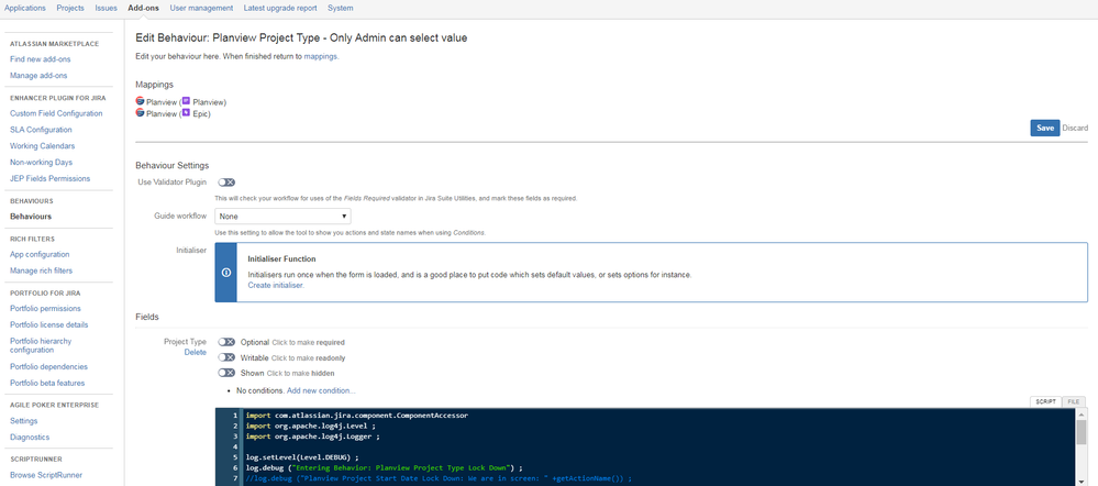

i have my Behavior linked to a personal project and to the Epic issuetype In said project.
My Behavior actually works fine when I am in the edit screen for Epics. The issue is that when I am in the Create screen for an Epic it does not work.
-Roberto
Yes but what does your configuration actually look like
@Tom Lister and @Nic Brough -Adaptavist-,
Below is the screenshot of my Behaviors config. As you can see I have mapped it to the right Project (Planview) and the right issuetype (Epic) and put the Behavior function on the right field "Project Type".
Once more, my code runs in the Planview project in the Epic issuetype on the Project Type field if I am in the Edit screen. It only does not run if I am on the "Create" screen.
If I look at the JIRA logs, none of my debugging statements display when I open the "Create" screen. All of my debugging statements display when I open the "Edit" screen. It seems that Behaviors are not running on Create screen. Does anyone know why? Could this be a JIRA setting I turned off?
