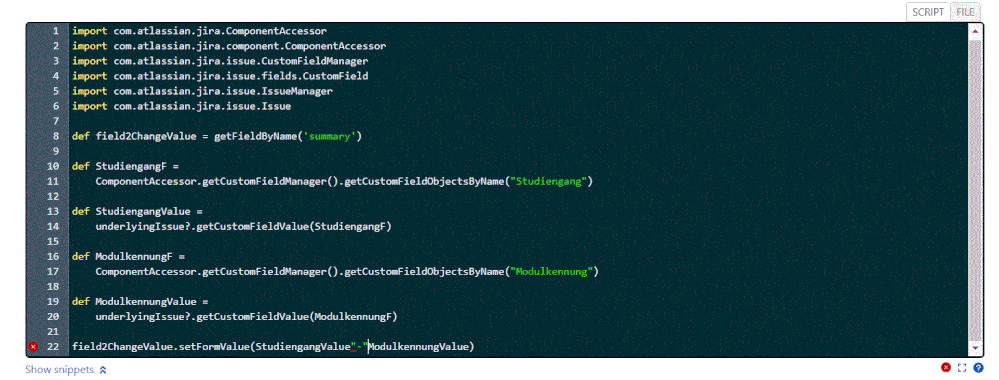

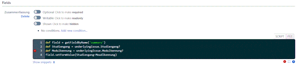

in Jira Automation I changed the Summary by concatenating two other issue field values as you see in the following figure.
Now I want to achieve the same result using Script Runner. Therefore I am trying to set an Behaviour, which fail. In the following figure I show you my script. Maybe I also have to use a listener instead but first of all I want to understand the basic script structure :)
Hi there, your script looks like it should work but can I just check what the 2 fields are? I'm presuming these are custom fields, so you might need to use this instead -
def maxToleranceDateCustomField = ComponentAccessor.getCustomFieldManager().getCustomFieldObjectsByName("Max Tolerance Date")
def maxTolerancedatestartingvalue = underlyingIssue?.getCustomFieldValue(maxToleranceDateCustomField)
something along those lines, obviously change my field name for your field names.
Also if the fields are on the form you can use
def CFFieldVal = getFieldByName("Insert Custom Field Name").getFormValue()

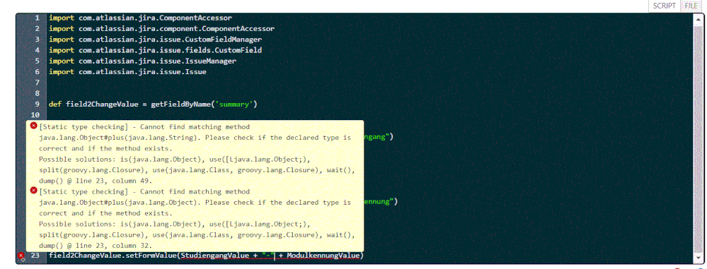

There are multiple ways to achieve the string you want :
(Customfield1 + "-" + customfield2)
("${customfield1}-${customfield2}")
if you wanted to subtract one from another I'm guessing they are both integers you can do just customfield1 - customfield2.

To achieve the string I tried both variants - but only the second one did work. In the figure below you see the error message I get using the first way.
Also I needed to change the "ComponentAccessor.getCustomFieldManager().getCustomFieldObjectByName(xxx)"-method in "ComponentAccessor.getCustomFieldManager().getCustomFieldObject(xxx)", to made this work.
That error is just static type checking and can be ignored in scriptrunner
