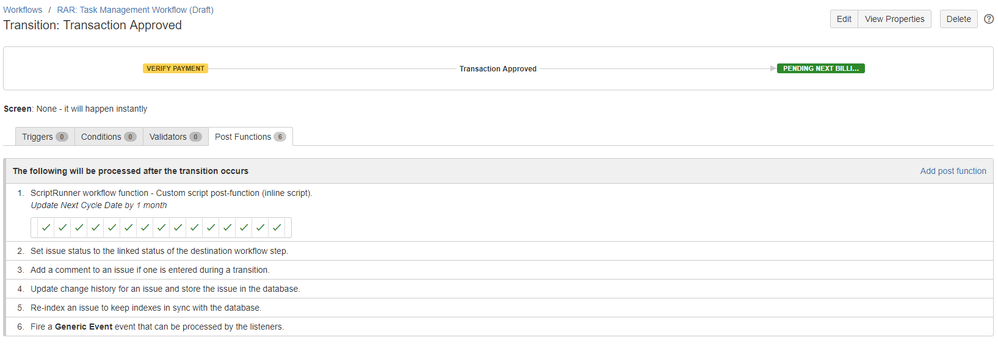

I would like to add 1 month to a custom date field (Next Cycle Date) and then update that date field upon a workflow transition (post-function).
I have the current script but it's not doing anything, not sure what I am doing wrong.

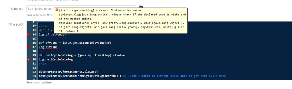

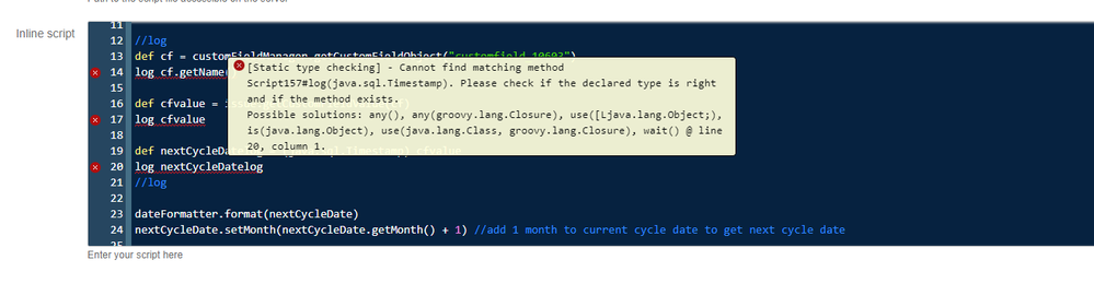

I'm having a bit of trouble with the logging method. Please see two screenshots showing errors.
Fixed the logging problem by importing the logging package and changing log to log.debug throughout.

Now it is working fine, and it is in the first of the postfunctions, and the transition is not create.. The transition is in the middle of the workflow.

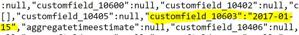

I am not sure how it sees it as null.. I go to http://myjirainstance:8080/rest/api/latest/issue/RAR-4 and have the value there:
I am not sure, how you call the script. But it seems to me that there is a error. You call getCustomFieldValue, but you should call issue.getCustomFieldValue.
