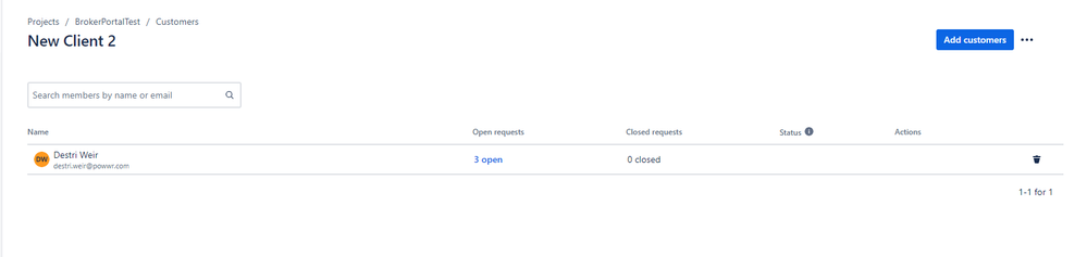

I am a user in the organization. I have this script running as a post function on the Create transition, I expect it to add the organization to a new request when I create one.
