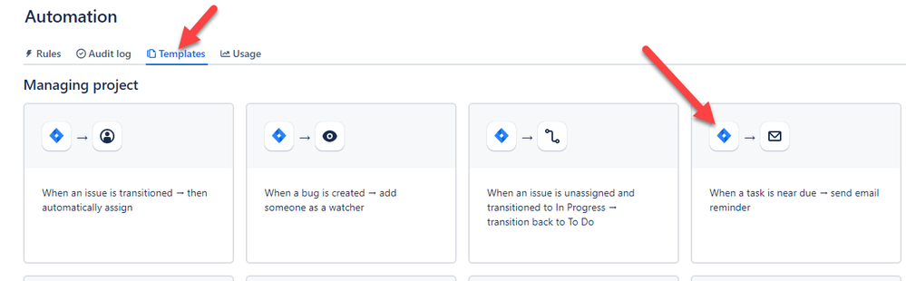

This is now a customizable template in project settings, automations, templates.
Template customizations
  • Adjust when to send (daily at XX:XX AM)
  • Notify user X amount of days before due date
  • Can customize the outbound email
