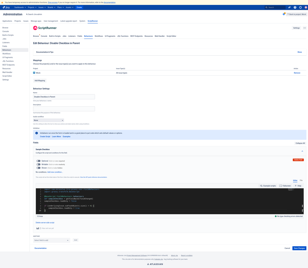

Below is a screenshot of the Server-Side Behaviour configuration:-
