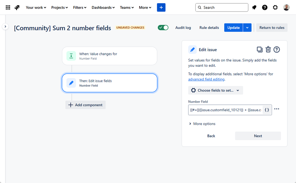

Hi @visby8em ,
Can you try using math expression directly in the field within Edit issue action (I'm assuming you're using this one?), and not necessarily advanced edit part of the action?
For example, if the third field is also number type (where you're summing previous two values), automation could look something like in the picture above.
You could just use the expression
{{#=}}{{issue.customfield_10121}} + {{issue.customfield_10126}}{{/}}
and it should work.
