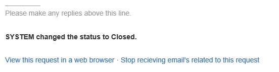

So i understand the point of the "close" issue email. However my users do not. I get comments such as "did you just do this now? i thought you did it days ago!" and other questions like "this notification means what?" and questions about what they should do with these emails.
Therefor i would like to suppress close notification emails. We don't need them at all. What is the most straightforward way of dealing with this, while still preserving the automation piece that does the actual closing the issue?

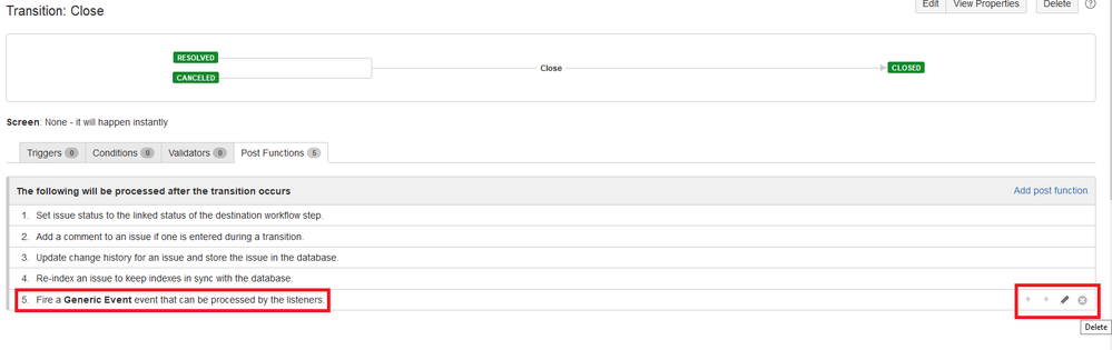

If i am interpreting this correctly, You are saying to remove the "generic event" step in the  'transition close' workflow.
If that works and has no negative repercussions elsewhere then that's and OK solution. Unfortunately i have to edit it for every request type but there are only 5 or 6 per site so not that big of a deal...
Only problem is that when i go to delete that step, the delete button is greyed out :(

As you can see you are using Generic Even for this specific transition (not Issue Closed), so eather change it to Issue Closed (which is already empty) or remove people/groups/roles from notification scheme associated with Generic Event

Ah ok finally had some time to look at this. Yes they are all set to generic. That is from the factory, i did not change this. It makes sense to set them all to "issue closed" notification   (project - Notifications).
i am wondering if the framwork for the event "issue closed" is all set up, why it wasnt set this way by default. I guess thats the only part confusing me here. I will set them all to "issue closed" on the closed transition and hopefully my problem goes away!
Nic Brough -Adaptavist-
July 16, 2018
It happens when you create a workflow from scratch - Jira doesn't know what events you might want to fire, but it has to put something in, so it just picks "generic" for everything.
