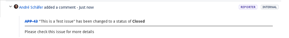

we're using Service desk project called SUPPORT and create linked issues to an Jira Software project called APP if a issue is confirmed. The linked issue is linked with "is caused by".
After closing the linked APP issue, there is a comment in the SUPPORT issue (see screenshot)

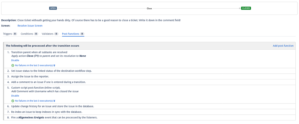

I've checked workflow post functions from open to close (see below)

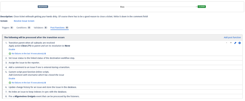

We've a second identically workflow step from reopened to close (see below) but in this step theres no comment added.

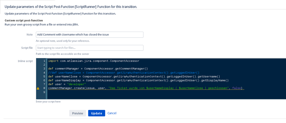

It seems that comment added with Scriptrunner Postfunction, try to check code,
Hi @Mark Markov
thank you for your reply. I've checked Scriptrunner postfunction code. Theres only this code inside
This code does not add the comment to linked issues I think.
