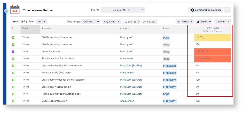

You can try a third-party add-on - Time between Statuses by SaaSJet. It helps to calculate how long it takes an issue to move from one status to another.
tbs.jfif
Can you clarify what is your initial status and which status means the issue is resolved?
Then we could help you to set up the add-on according to your needs.
