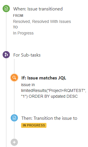

We are looking to use Project Automation to reopen the most recently closed sub-task when the Parent transitions from Resolved > In Progress.
To identify the most recently updated sub-task, I'm using "issue in limitedResults("Project=[ProjName]","1") ORDER BY updated DESC" from the Go! JQL add-on, but I can't figure out how to apply the transition to the resulting subtask. Below is what we've built to-date:
Any suggestions would be appreciated
If I'm not mistaken, the second condition return all the issue from the project but limit the number of result to 1, returning the lat updated issue of the project.
It do not seems to be what you are looking for.
You are looking for something more like project = RQMTEST and parent = {{triggerIssue.key}} if it support that.
Regards
This worked perfectly, thanks! I updated the If: Issue matches JQL to the following:
issue in limitedResults("parent = {{triggerIssue.key}}","1") ORDER BY updated DESC
Is there a reason (possibly best practice?) to include the project in the query? I tested with and without and didn't notice a difference in the time taken to complete the automation.
Not sure, in this case parent field is already limiting the scope to the project the trigger issue is in.
