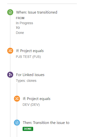

For starters you want something like this, and then build from it. Create an automation rule for each of your own rules to keep it simple.

Thanks a lot, For Linked Issues was the missing part to my puzzle.

Let's take these a one at a time as you will need multiple rules.
Let's deal with the issue in the TEST board moving from DONE To IN PROGRESS.
Create an Automation Rule based on an Issue Transitioned Trigger - use the two statuses as you describe.
Then add a Branch based on Linked Issues
Under the Branch add an action for Transition Issue and then add the statuses that you describe for the action in the DEV board.
Do that one and test it. Then see if you can do the others based on what you have learned.
