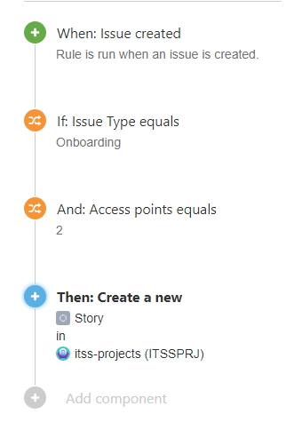

I'm assuming your rule structurally looks similar to this:

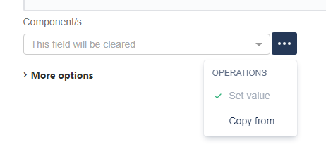

In the Create Issue action when you select a field to fill in you have an option to set an explicit value or copy the value.
You could either be using smart values to explicitly set the field thus:
{{triggerIssue.Name of Source Field}}
Or you could select the Copy from option.
Which method are you using?
If you select the Copy from option the field input automatically changes to copy from a field of the same name in the Current Issue:
If you click on that text you get a pop-up to change the issue you are getting the data from, and depending on the field type you may also have an option to change the field from which you are getting the data. You should be changing this at a minimum to get the data from the Trigger Issue.
Once you tell us about the method you are using to set the field values, and what value choices you are making for that method, we can provide additional advice.
