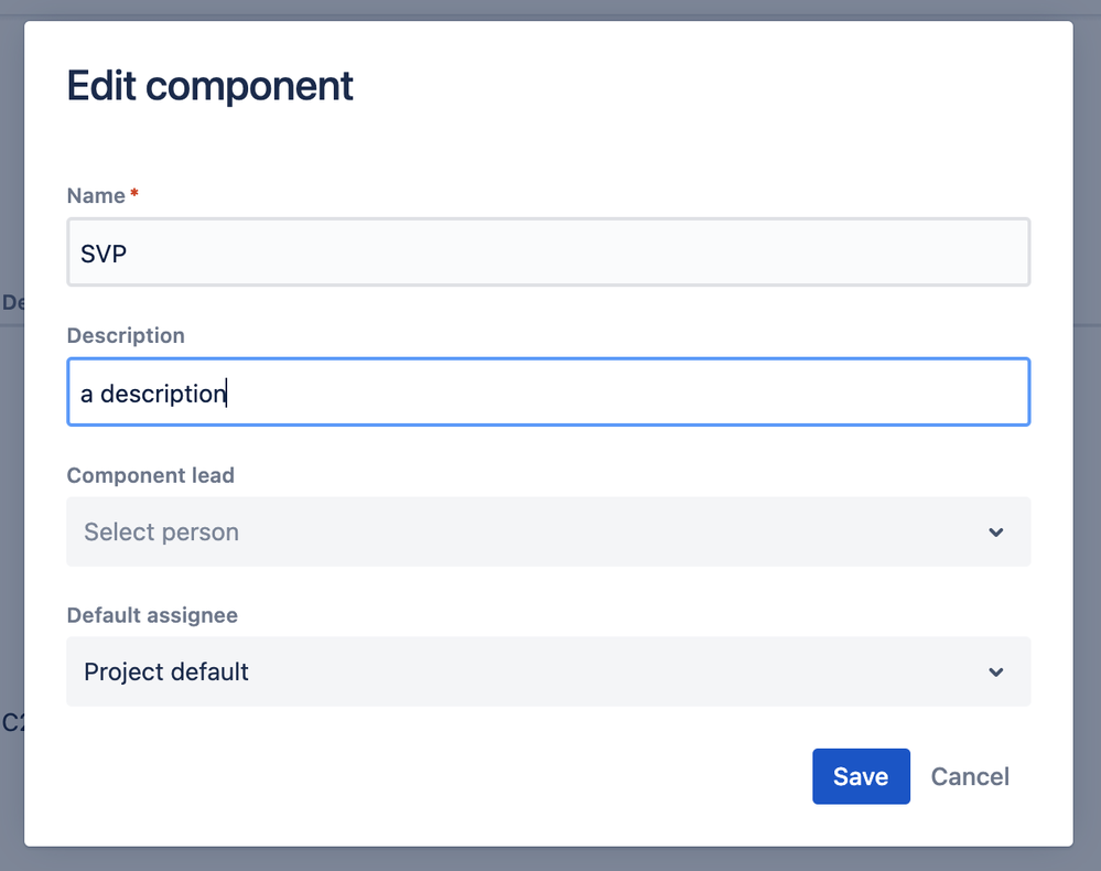

David Fischer
March 24, 2021
Hi Steven,
the "name" field is the component name, while the "description" field is the component description, as defined in Jira:
