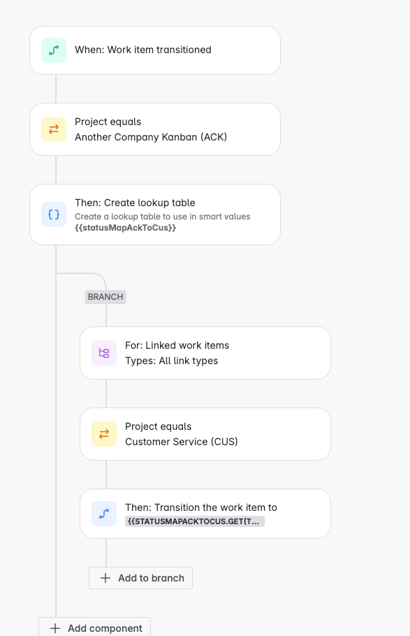

Here's a quick rundown in images. If more details are needed, I suggest that you tell your admins to join the Community and participate in this Question so that the conversations don't have to go through you.

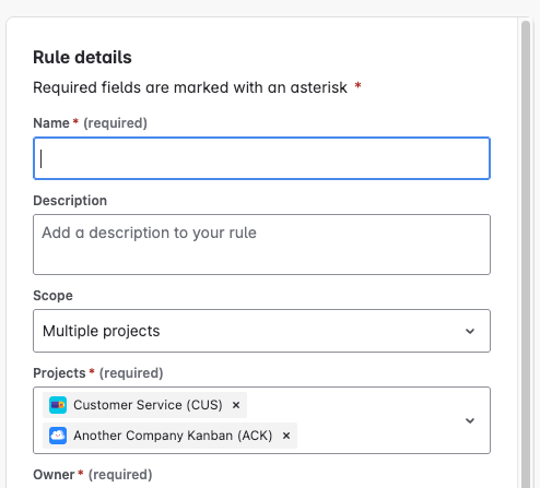

Rule Details where the scope is set to both projects
Rule

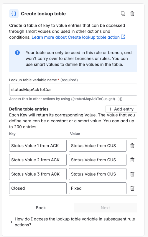

Details of Lookup Table step

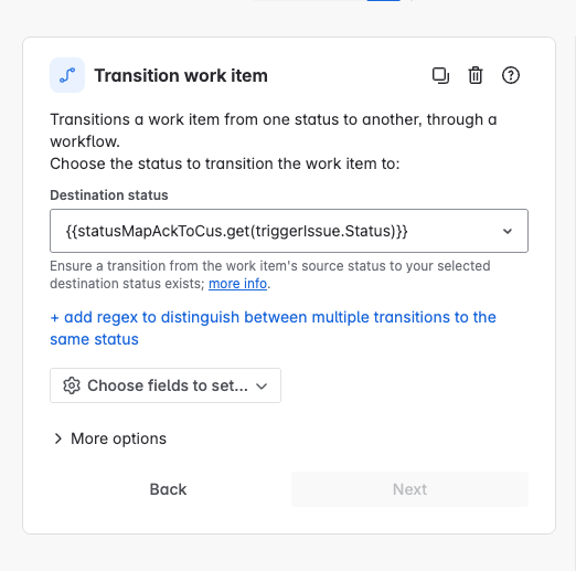

Details of transition step

This is great! I really appreciate your time. Just one more question. We did go in and add a workflow in CSD that replicates the statuses that go through DEV and renamed them for customer facing statuses.
So would we need a lookup table if the status fields for PDEV are already in CSD?

Hello there, we're trying to follow this but I dont see anything to update the scope to multiple in the dropdown that you showed.
We were able to figure it out using some of your suggestions above. We didn't need to use the lookup table. Thank you so much for your time and help.

The scope drop-down is available only to Jira Admins accessing the Global Automation option available through System settings.
