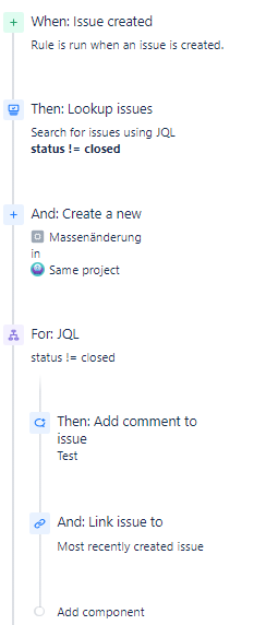

I have following use case, which already works
When a new issue is created (Trigger)
look, if there are already existing issues with similar information based on JQL (Lookup)
Create a new ticket with some information of all found issues (Create new issue)
for every found ticket (JQL-Branch)
 - create a comment (Create a comment)
 - link it to new created ticket (Link issues)
Now my question:
Is it possible to use an advanced Branching instead of JQL-Branching to achieve the same outcome?
It is highly dissatisfying to use the same JQL two times instead of reusing the "code".
When I switch the branching type, the comments and links were added to the triggerissue, instead of the issues of the lookup result.
Do I have to access the lookup result in a special way other than "{{lookupIssues}}"?

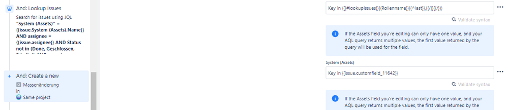

First thing, what problem are you trying to solve by doing this (i.e., why do this)?  I ask because what you describe, "if there are already existing issues with similar information", does not match the JQL used, as that only tests on status; there is nothing matching to the created issue.
As mentioned, I simplified the automation in my comment. The real query in the lookup is:
"System (Assets)" = {{issue.System (Assets).Name}} AND assignee = {{issue.assignee}} AND Status not in (Done, Geschlossen, Erledigt) AND reporter = {{issue.reporter}} AND issuetype != Massenänderung
Now I am accessing the field "Rollenname" in every found issue to populate a multivalue asset field while creating a new ticket.
Key in ({{#lookupIssues}}{{Rollenname}}{{^last}},{{/}}{{/}})
After creating this new issue, I want to update the found issues in the lookup. To iterate over them, I am using the same query.
